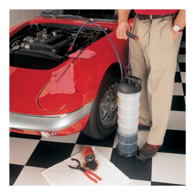

I've used this item to change my oil for years!
http://s7d4.scene7.com/is/image/Grio...10122?$detail$
Great thing about using this is that since rotary engine has oil filter from the top, you don't EVER have to jack up your car to change oil!
All you have to do is insert one of 2 probe down the dip stick hole and SUCK IT UP! Ok.. That sounded kind of weird....
I could change my oil in 15 mins. Mostly just waiting for the pump to extract out the oil from the oil pan. Some say this will extract more oil than conventional draining.. I've measured before and its about the same.. If there is might be 1-2% DIFFERENCE!
I paid about $85 shipped from, http://www.griotsgarage.com
Search for "Oil Extractor".
I ALSO use this to empty out coolant from radiator and I also have a brake extractor.. Which is pretty much the same as this unit.

This is a great little tool. I have one too(thanks to Phil showing me these a few years ago) and use it from time to time when I'm in a hurry.

Notice in the photo this guy just dumps out his oil filter.

thanks for letting me in on this. I ordered mine a few weeks ago and it works great it pulled 5 quarts out of my FD and since the FD's oil filter is easy to get to its great. my blazers oil filter is right under the front bumper area and i use it on that also. but kinda usless if you have to get under the car to get the oil filter off. i got mine here. i just got the Pela 6000.
