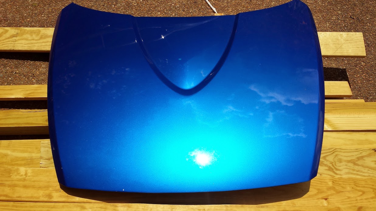

Started with a beautiful blue hood from a local forum member.

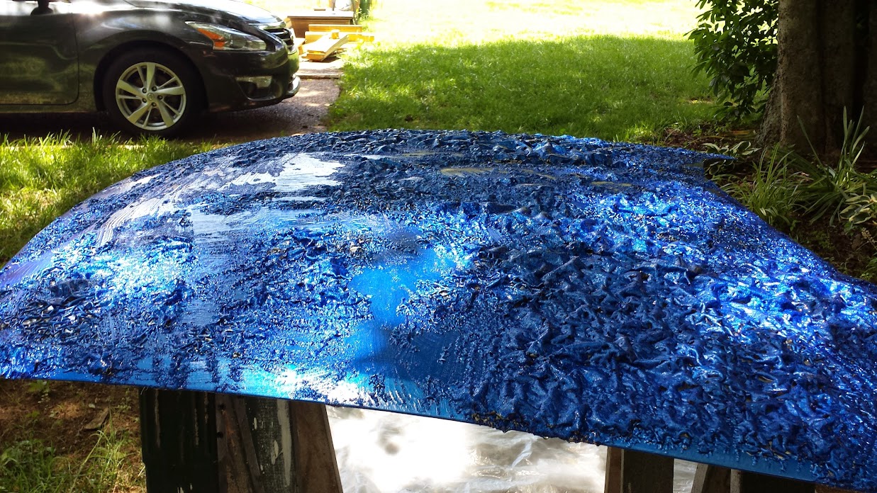

Super aggressive paint stripper. I watched the stripper move across the hood as paint bubbled up.
Not me in the picture. And you can tell by the hat he's not really gangster. Hood after 2nd round of stripping.

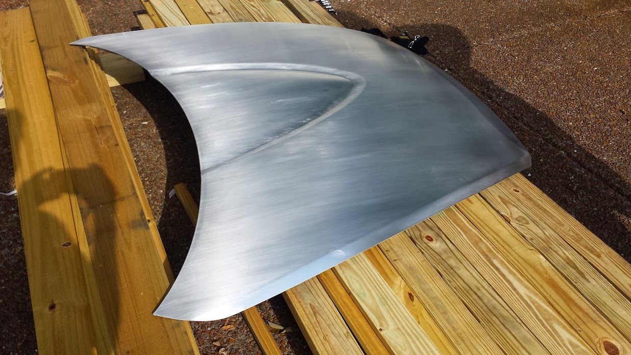

After "brushing" the aluminum with a 3M pad. Still debating on how to continue the finish as the brush lines are hard to keep straight. I just want something uniform without scratch marks everywhere.
