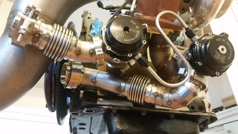

RXtacy 03-15-2016 08:34 AM
I have also begun fabricating my WG recirc tubes. They are going to be really tight, but should work out nicely. Still need to finish the transition to the DP.

rotarynerdette 03-16-2016 12:30 PM
Those welds have come a long way.
RXtacy 03-16-2016 01:04 PM
You're telling me! Looking back is pretty embarrassing now, but you gotta start somewhere. :icon_tup:
chibikougan 03-16-2016 01:12 PM
Well with the pro shops manifolds showing up looking much worse even when they half assed polish their undercut ... So I would not be embarrassed one bit!
rotarynerdette 03-16-2016 05:17 PM
That is very true, I can't even keep a steady bead yet.
RXtacy 03-16-2016 07:24 PM
Other than the basic mechanics of torch angle, and keeping the filler in the shield gas the biggest lesson I learned was fit up is key. Tight fit up makes a good weld. I found running beads repetitively on an aluminum sheet helpful in the beginning to get the basics, then just stick as much scrap together as you can get your hands on. Keep at it, it's a great skill to have :icon_tup:
