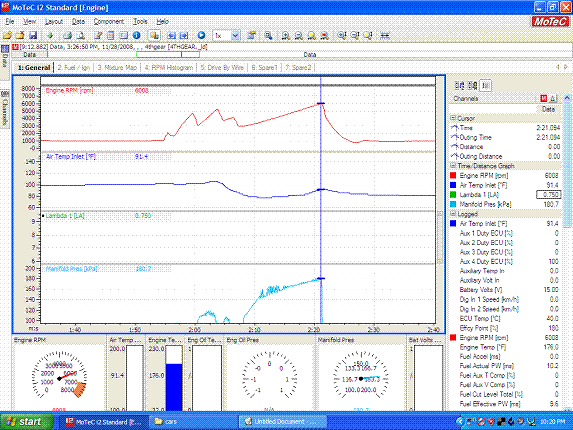

1 Attachment(s)
Here is a 4th gear pull from about 3000 to 6000 RPMs. I have a 9psi wastegate spring, but you can see, in 4th, it gets up to about 12 psi. The car is tune for that range, so it isn't a big deal... The turbo is just letting me know it wants to be opened up some more!!
The outside temp was around 70*F. I am running 50/50 water/methanol. It's great to see the AIT drop under boost like that.

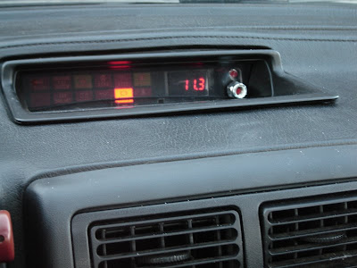

I spent the day mounting my Lambda gauge in place of the stock (worthless) clock. It was a little tricky. What do you think?
http://4.bp.blogspot.com/_AEAL2Ej4Lg...s400/int01.jpg
http://2.bp.blogspot.com/_AEAL2Ej4Lg...s400/int02.jpg
WE3RX7 11-29-2008 11:56 PM
Thats a slick place to mount the lambda - consider that idea stolen for me :)
