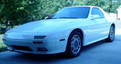

I have had my FC for a long time. Going on 7+years I think. It started its life as a lowly one owner 1990 GXL. I did nothing but drive it for a few years. She ran like a champ, and was a great car. AC was ice cold, everything worked the way it should.
http://lh6.ggpht.com/_OFjbTkyhkOs/R7...0/DSC00542.JPG

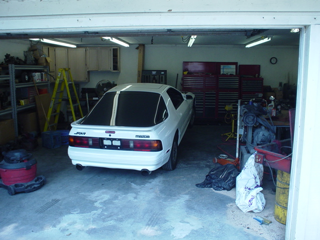

Time for a turbo swap.
http://lh3.ggpht.com/_OFjbTkyhkOs/R7...0/DSC00557.JPG

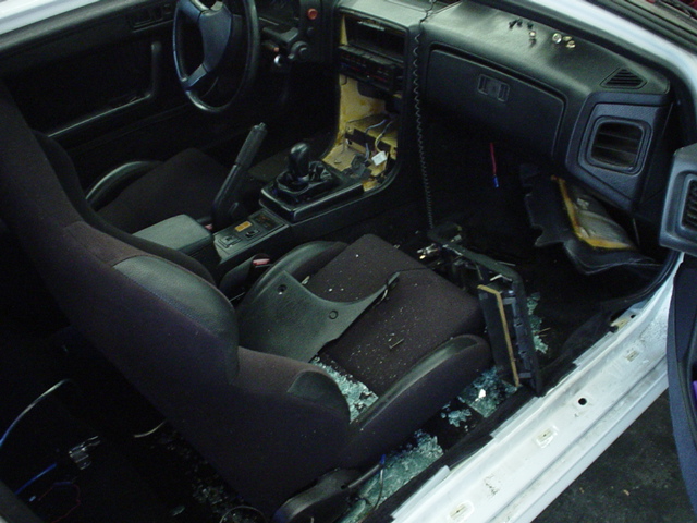

While the swap was taking place, waiting on the engine to be built, it was broken into. That is a whole other drama situation. They got an Alpine flip out touchscreen with DVD player, a 10" sub and amp.
http://lh5.ggpht.com/_OFjbTkyhkOs/R7...0/DSC00560.JPG

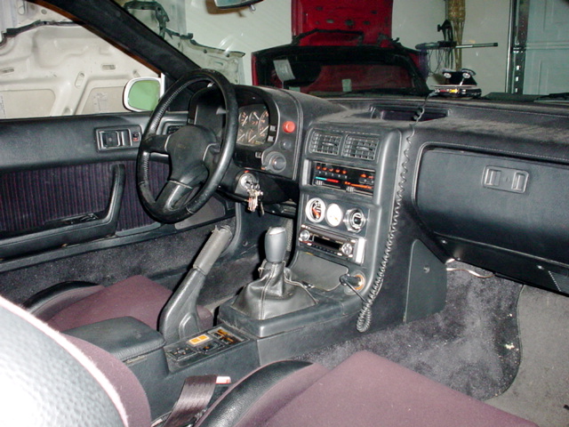

So, I did an audio downgrade, and a gauge upgrade.
http://lh5.ggpht.com/_OFjbTkyhkOs/R7...0/DSC00635.JPG

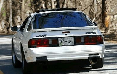

Next was the exhaust. I picked up an Apexi N1 Evo catback from a local guy, and gave away the shitty old one. Also added an Apexi Twin Chamber BOV.
http://lh3.ggpht.com/_OFjbTkyhkOs/R7...0/DSC00942.JPG
