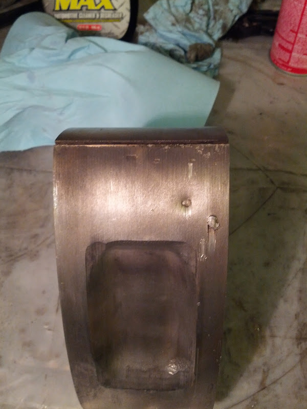

The culprit.
https://lh3.googleusercontent.com/-B...110_203917.jpg
https://lh3.googleusercontent.com/-N...110_203842.jpg

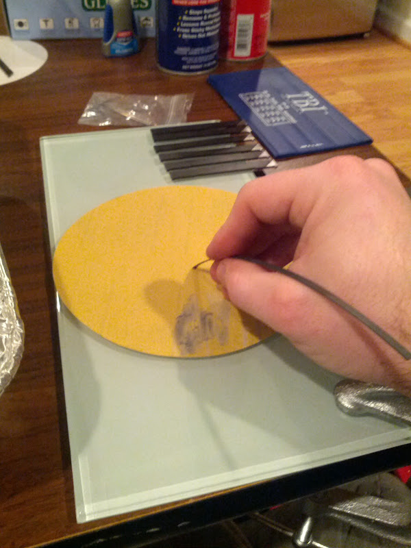

Ordered up all the soft seals, new side seals, corner seals etc. Also got my ID 1000 primary injectors and new RX-8 e-shaft.
https://lh3.googleusercontent.com/-u...112_223834.jpg
Cleaned up primary and secondary ports. Didn't enlarge much at all, just cleaned up the casting for the most part. I wanted to keep them as close to stock as possible. I have another way of increasing air into the engine :suspect:
https://lh3.googleusercontent.com/--...319_184909.jpg
https://lh3.googleusercontent.com/-E...311_202427.jpg
https://lh3.googleusercontent.com/-G...311_154539.jpg
https://lh3.googleusercontent.com/-C...311_154657.jpg

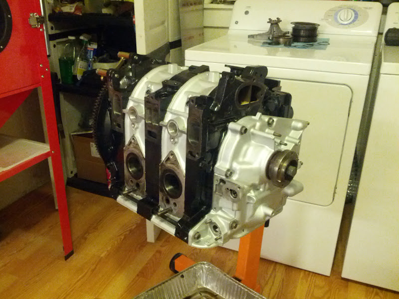

Keg together.
https://lh3.googleusercontent.com/-Z...427_171316.jpg
https://lh3.googleusercontent.com/-m...427_171238.jpg
Front cover installed.
