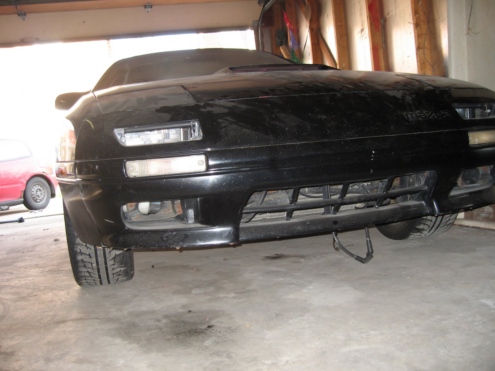

Generic nose shot, nothing special to see here really, just dust.
I did get my hands on some FTP lenses and OE fog lamps, which will do just fine thank you.

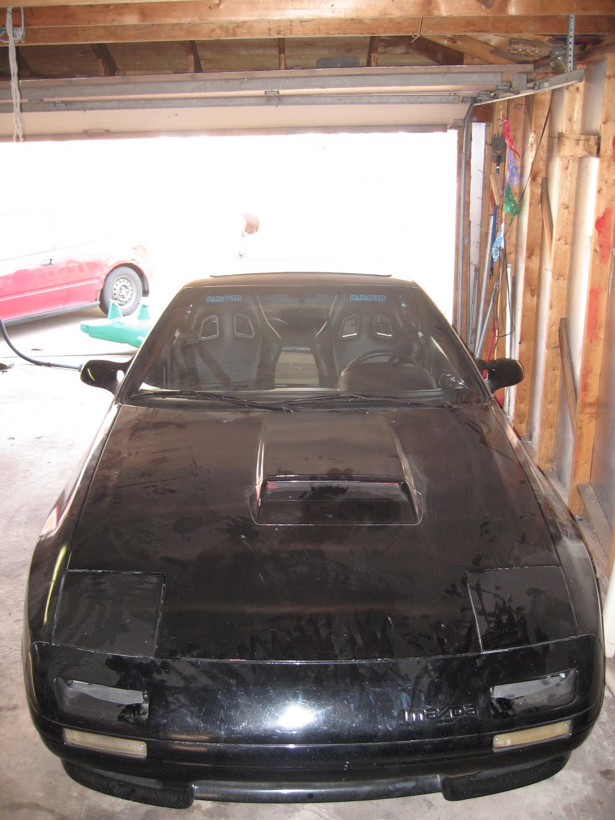

Raised shot from the front, I did notice after purchasing unfortunately, the hood appears to have been repainted and swapped from another car, you can clearly see the red paint in this shot. I guess it is not as obvious in person at eye level. Fortunately, I did not see any signs of serious front end damage/work.
You can also see the "Mazdaspeed" seats it came with in this shot. The seats don't look so bad, but I found the fitment was poor, and the seating position never seemed quite right; it was hard to be completely comfortable in them. Luckily, the previous owner included the tattered old OE seats, which I hope to get reupholstered and reinstalled.

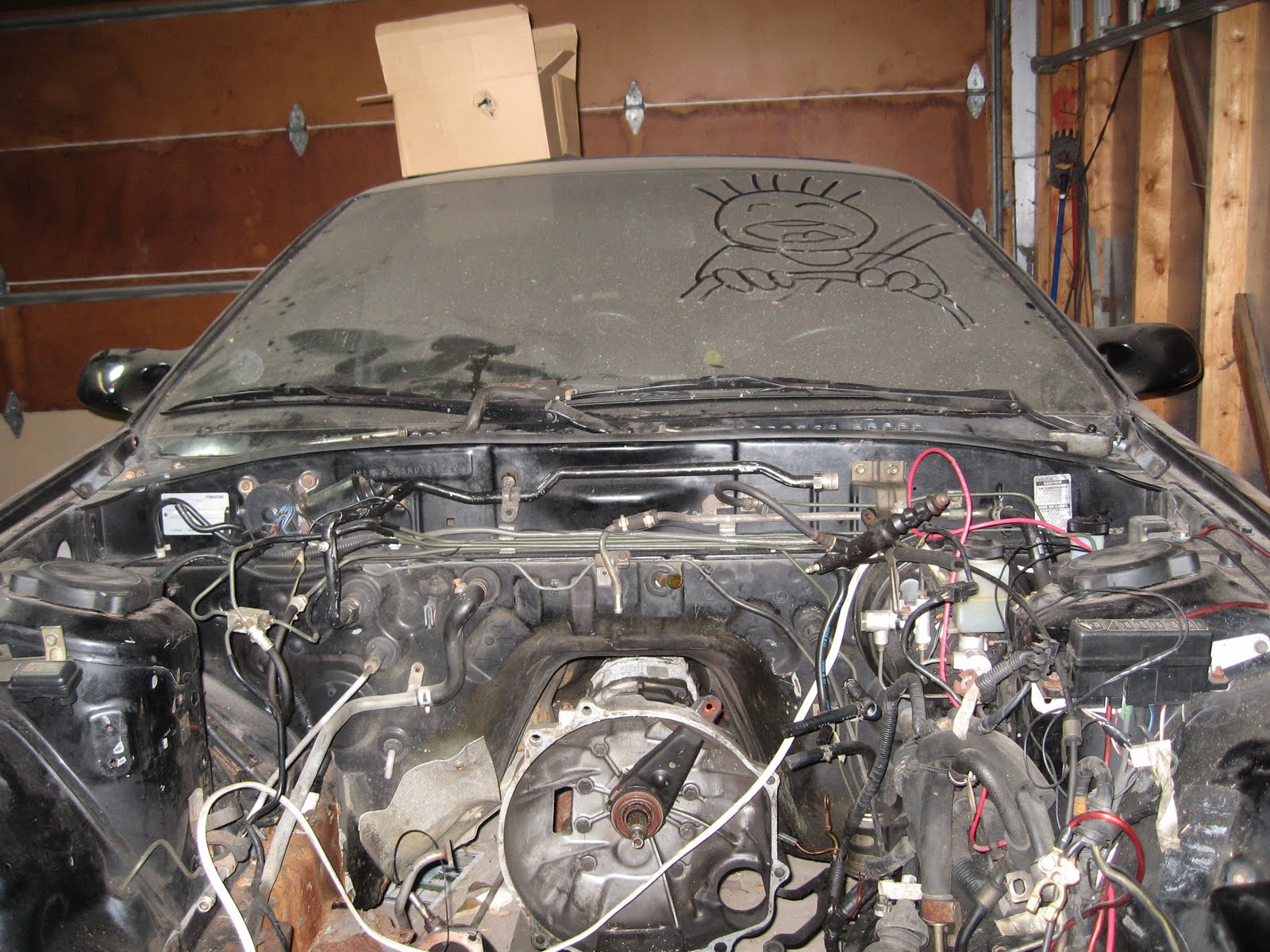

I did not have much time for the car today (as is often the case), so I decided to get one little job done while I had the chance. I pulled the "Mazdaspeed" seats out of the car, along with the center console, to begin pulling up the interior. In the process I discovered the seat rails were beginning to rust at the mounting points. I figure this is less than ideal, so I set about grinding off the rust, priming and repainting. I also got some new shots of the engine bay with the engine already pulled, and some trouble spots I am concerned about.
Also, I have a little name that part quiz for you guys, if you scroll down through the pics, see if you can name the clutch and pressure plate that was pulled from the engine. It came with the car, so I have no idea what it is, does not look OE though.
That's not me, that's Dusty.

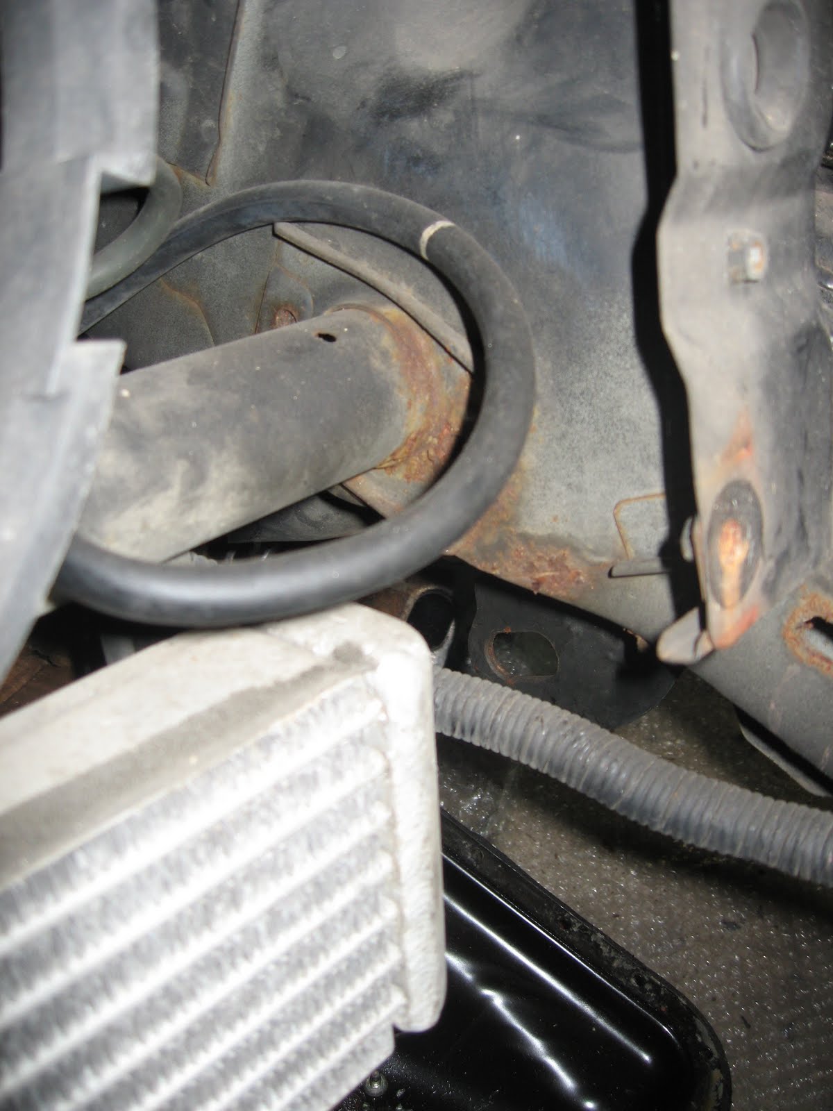

Rust worries
Here is the rust I am particularly worried about. Anyone have any pointers, advice or words of warning as far as dealing with rust in these areas?
This is probably the worst spot, my ABS pump was dribbling brake fluid onto the body and probably had been for quite some time. V
This is right where the front support mounts up on the driver side. V
Passenger side is about the same. V

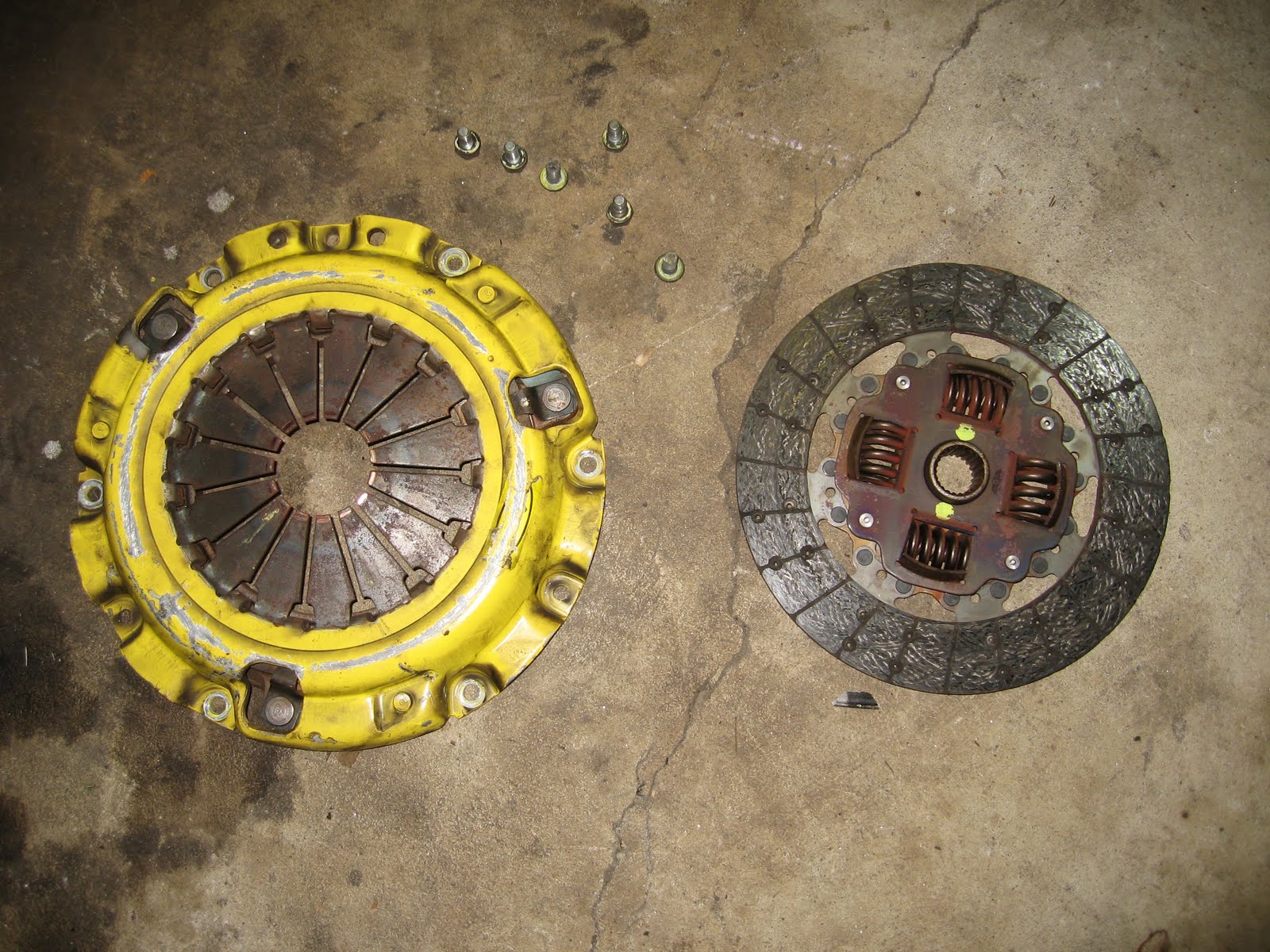

Name that clutch!
So what do you guys think, any expert eyes that can tell me what my mystery clutch is?

Doesn't ACT usually do yellow pressure plates? LOL at Dusty

Lift the car in the air, remove subframe. Get an angle grinder with a twist knot wire wheel. Strip all rust and cover it with the shit in that article, then get the engine bay repainted.
Do the same to the subframe, but do some welding on it for extra reinforcement, and get it powdercoated for lifetime protection.
Clutch is 100% ACT. The logo is still on it, and it's trademark yellow.

Thanks for the answers guys, I kind of figured it was ACT.
Max777, getting rid of the ABS delete kit is on the agenda for sure. I have still been entertaining the thought of keeping ABS, but I still can't stomach the cost of the new pump. As to the rust, I guess it is not that bad, just looks bad. I am noticing some crushing at the jack points though under the runners, that has me a bit worried too. I do plan to do some serious grinding on the engine bay one of these weekends.
