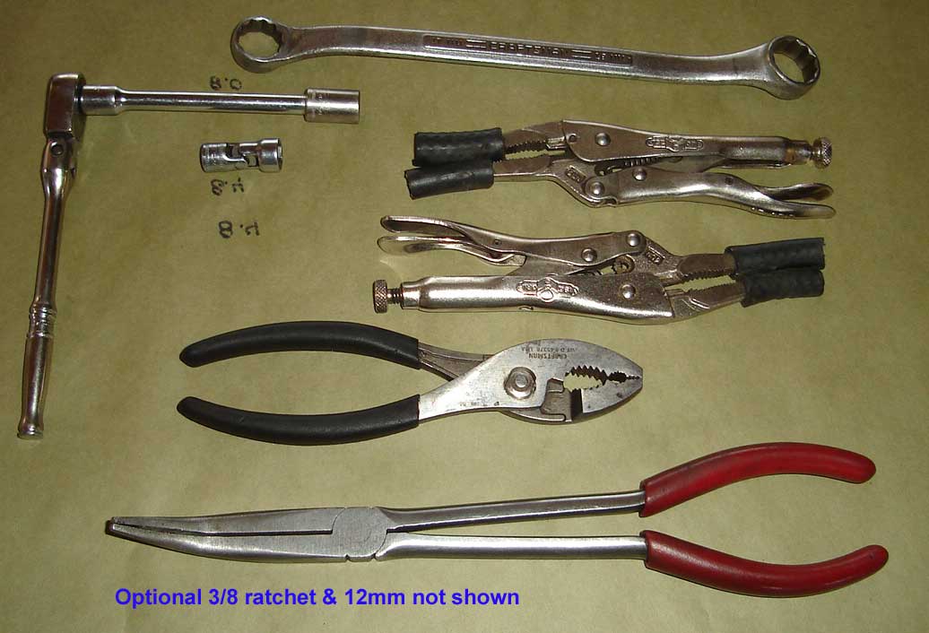

Tools needed;
·¼ inch ratchet – 3 inch extension – 10mm socket – optional 10mm uni
·option 3/8 ratchet with 12mm socket
·2 mini needle nose vise grips with fuel line covering jaws
·long nose 45° pliers
·standard pliers
·good light source
-small arms are really helpful
large image:
http://www.rotaryresponse.com/RCC/FfilterTools.jpg
