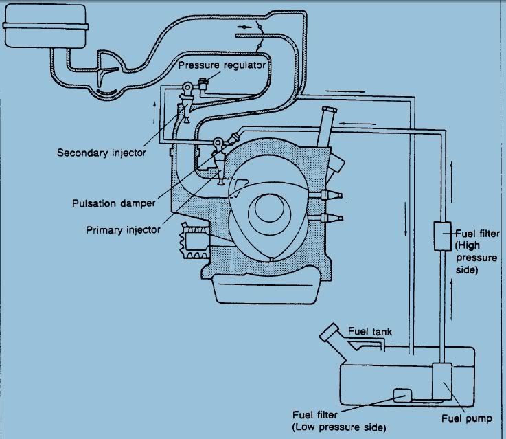

My grandson has a 1986 RX 7 that overheated really bad, after overhauling the enging cranks but wont run. If you spray gas in the intake it runs good until the vapors are gone. I'm stumped as what to look for

What do you mean by overhaul? Did you replace all internals apex seal etc? Also are you sure you are getting fuel? You can check the EGI fuse in the fuse block under the hood. Are all injectors plugged in? Fuel lines connected properly?

From what you are saying I would lean more towards you are not getting fuel. You can easily check this by removing spark plugs and turning the car over to see if there is any fuel mist. Make sure the plug wires are not connected. When done with that pull the EGI fuse and crank it over to unflood the engine if indeed you do have fuel. If there is no fuel test the EGI fuse. Make sure the fuel feed line" The on with the fuel filter" is connected to the lower and or primary fuel rail and the line from the secondary goes back to the hardline for the tank.

make sure fuel lines are right . also, check ground wire from engine harness. mounts to block under intake . seen this missed many times before.also, check if screw fell out of pulsation damper (lower rail plastic cover over it) .you can also jump the yellow connector at the right shock tower to trigger the fuel pump. these are the common items . hope that helps.

It could also be the resistor pack in the '86 and early '87 models years they used low impedance injectors, with a resistor bank feeding them. Make sure that you have power to one side of the fuel injectors when the key is on.
