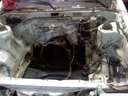

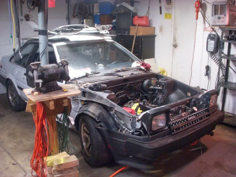

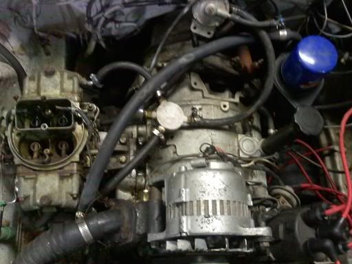

I picked this up a few months back and have been working furiously on it all winter trying to get on the track as soon as it opens!
this is how it started-

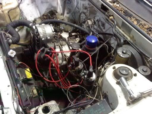

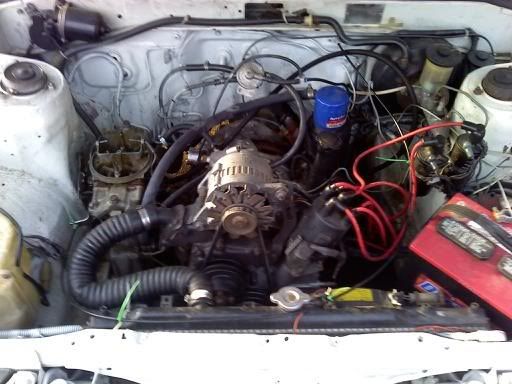

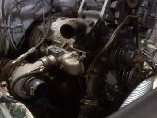

12a draw through t3 with a holley 650 double pumper perched on top

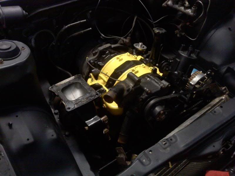

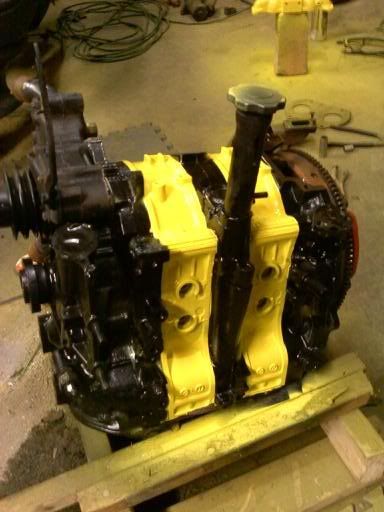

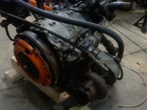

after taking everything apart in goes the new, 12a with a very large street port more power!

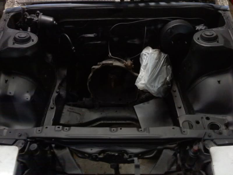

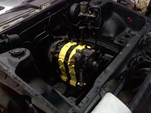

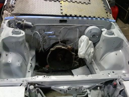

then cleaned and painted the engine bay
finally I am here with the alternator remounted to the side, wires all hidden, new radiator mounted fd style with oil cooler mounted perpendicular to that-
so no more bee hive and I can actually keep it cool, the last radiator was the stock one which restricted flow enough the initial owner just removed the thermostat
I'm waiting for my Holley rebuild kit to come in the mail with new jets to hopfully get it running a little better this time around, it was previously set up to drag, idle was around 1800 and it flooded out constantly, not to mention eventually I plan on redesigning the way the turbo is set up so the intake is the lowest point

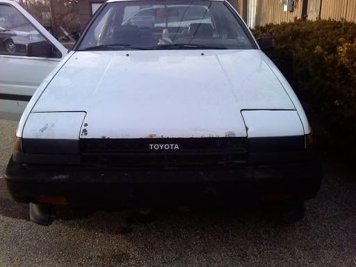

Looks like it is in desperate need of some rust repair!!!
Old 03-14-2010, 06:08 PM   #8
12arotary
tumor-syphilis-itis-osis
12arotary's Avatar
Posts: 191
12arotary is on a distinguished road
no actually, that back wheel is the only spot, and for an 80's Toyota I'm very lucky-
plus really no point in getting that into the cosmetics when odds are I'll wreck it before the end of the year
