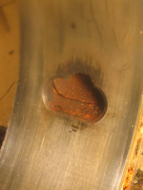

7. Where the bolt went thru the exhaust port theres a gouge. I'll have to get
a picture up of that but I'm thinking the street port of the exhaust may take
care of it.

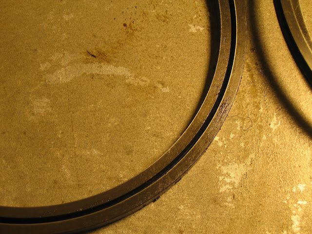

Check how much of the edge is shiny (I think there is a spec in the FSM). Replace the O-rings for sure.
care of it.
Up to you, I was told my a good friend whose porting ability I respect that if you think that bigger is always better - leave the exhaust port alone.

So the oil control rings are not shiny at all and I assume that means they
are fairly new and reusable?

On the porting, I also think bigger is not always better but most of the
SP exhaust looked they would cover this area. Need pics for sure so you
all can advise me on that. I think I'll do the porting but haven't decided
yet.

Bearings are like $30.00 new (for 2) I think I would go that route, the chance of damaging them removing them is not entirely remote.
There should be a small ring around the metal part of the oil control ring that rides on the plate. I would expect this to be shiny (unless it rusted in the coolant).
If a seal is questionable, do yourself a favor and replace it. Better 1 seal than the whole rotor assembly.

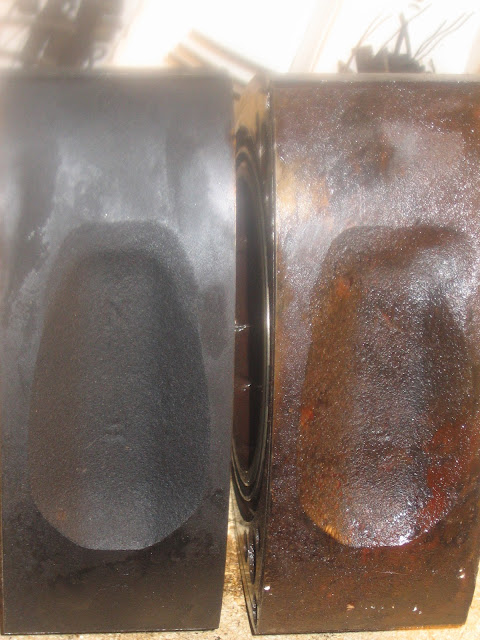

How not to port exhaust (note many changes in taper angle and flow restrictions, early open and late close). Made 255 WHp at 10 psi.
Much prettier exhaust port (consistent, near ideal taper angle, no avoidable flow restrictions, stock open and close timing). Made 216 WHp at 0 psi.

Your referring to the 2 oil control rings on each side of the rotors right?
I'll be getting a full soft seal kit so I expect that will include the o-rings for the
oil control seals. The A engine oil control seals look brand new, no shiny area
at all. The B ones definitely look older and worn and are shiny about half way
across, probably out of spec as well.

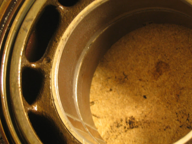

Heres the A engine when I got it:
This is what all the oil control rings looked like.
The rotor bearings (like new, mostly silver with a touch of copper at the seams)
The damage the bolt did to the rear housing as it left the exhaust. I'm thinking
porting will take care of it. If not I'll use one of the other housings from engine B.
The right rotor shows a dent in the top edge of the combustion indent. None
of the apex seals got damaged and none of the apex seal slots looks
damaged. I think I can use the rotor? Opinions? Remember its a budget build.

I think I can reuse the dented rotor. It seems fine other than the dent near
the combustion indent. I was able to get all the side seals out of it and the
rest of the rotor appears fine.

If the dent has not deformed any seal grooves, the only thing that you need to worry about is the balance. That will probably be fine, as street ported engines don't typically make much power over 8,000 rpm anyway.
