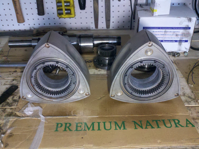

I had everything back for a while so I decided to take some pictures of the shiny stuff. Lapped/cleaned intermediate plates (thanks Chips Motorsports!):
Resurfaced/cleaned rotor housings (thanks Goopy Performance!):
Clean rotors:
For giggles I put the plates and housings together. I actually kind of like the grey/silver theme. It will definitely be easier to spot leaks versus those on black/silver or black/grey parts.

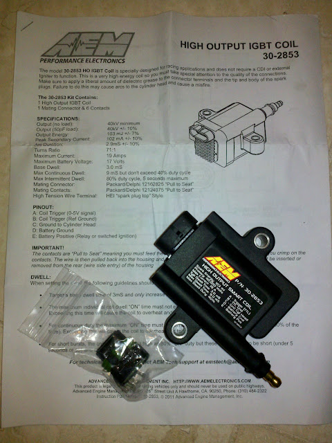

Last, but not least, the new coils. Currently have 3/4 needed. Now I need to figure out how to mount these things. They're a lot bigger than I thought!

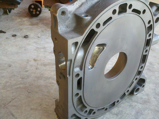

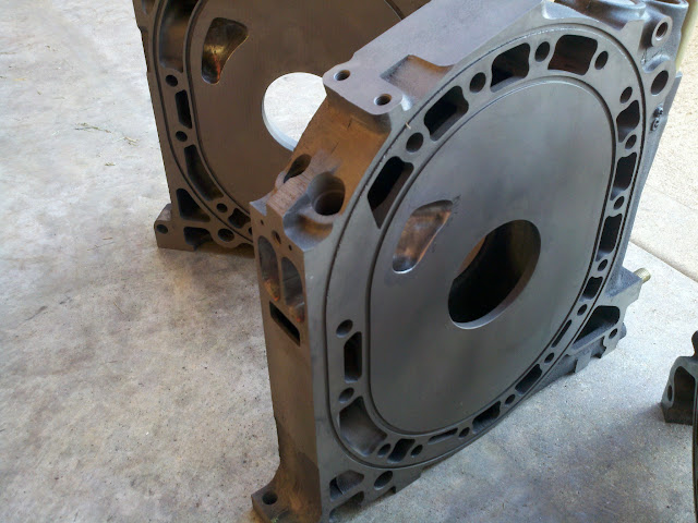

A while back Logan finished up the porting for me so I made a drive up to Columbus and picked them up.
Intermediate iron:
Rear iron:
Exhaust port:
Exhaust port again:
Porting work on outside:

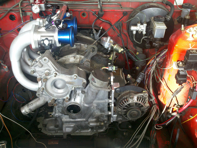

Engine-wise EFI Hardware TB has been ordered and Defined Autoworks is starting the intake manifold. Progress...
