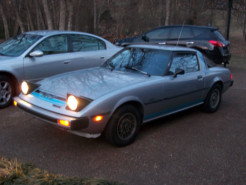

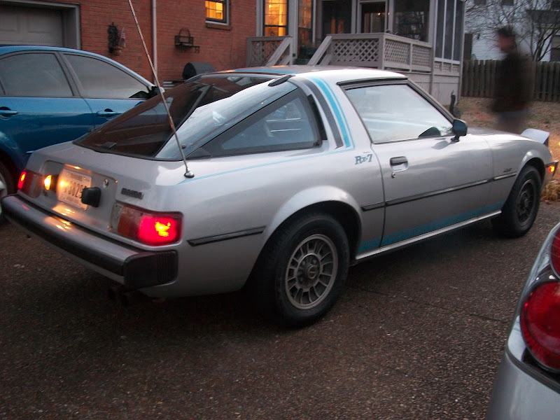

'79 SA 149k with 45k rebuild.
Good
- Beautiful Silver paint with "custom" pinstripes (not a fan of the Rx-7 Stickers)
- Very decent if not awesome interior
- Rock solid idle when warm
Bad
- One rust bubble on rear fender
- Noisy rear end (probably wheel bearings)
- omp lines were connected wrong, but immediately remedied
- oil cooler bracket is broken and currently held up with string... yes.. string...
Overall it's a 30 year old car that is in relatively excellent shape. Planning on fixing the rear end, giving the suspension/steering a once over, and doing the maintenance on the engine replacing vacuum lines, oil, plugs, etc. I has Autolite plugs in it, and while normally I would say only use NGK... the things idles wonderfully and runs decent, so they can't be too bad.
Photos taken just seconds after getting home in poor light.

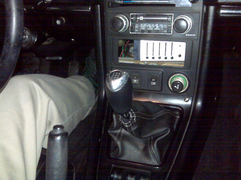

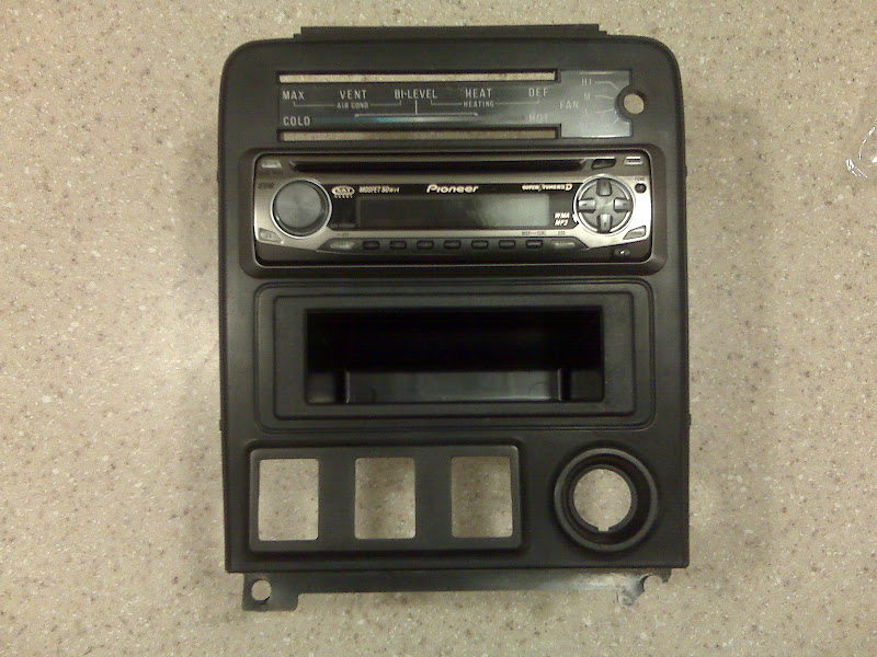

Couldn't wait. I made a Indyparts shift boot fit the SA trim with a 5spd Rx-8 knob. Now its time to replace that radio, equalizer, and get new shifter bushings when I can... I used a crappy camera but the idea is there.

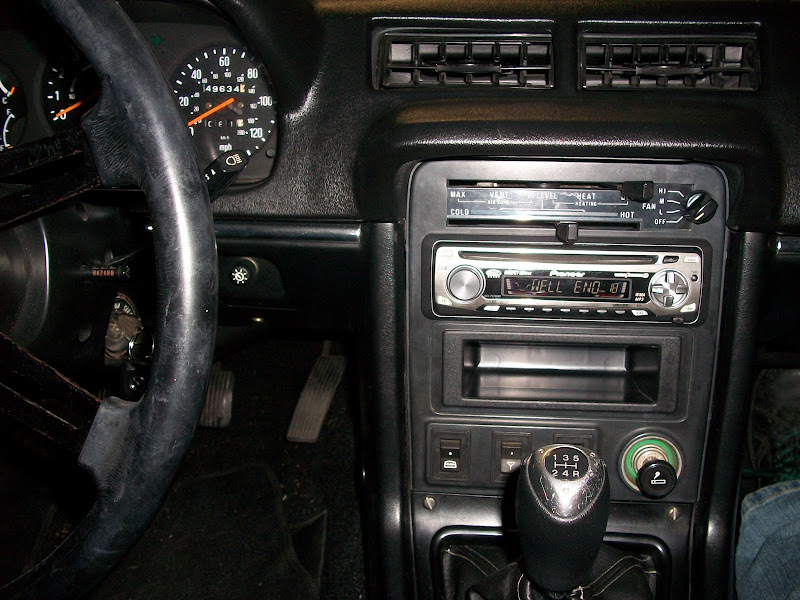

Bought a spare panel and added a radio with a pocket from mazdatrix. See above pic that shows a old two post radio and weird equalizer... I think this will add a little more functionality...

That stereo is full of win.
Where'd you get it?

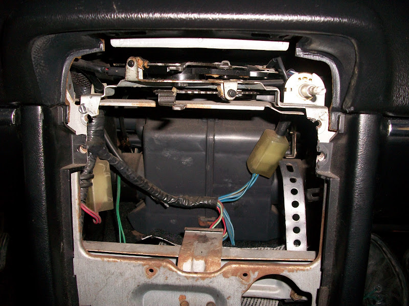

This first pic shows the trimming of the dash to fit the radio. Only took about a half inch on each side but I had to cut through two nuts welded to the back of the panel. Lickily, the two bolts for the dash aren't necessary and the whole center console is still strong and doesn't move. I drilled a small hole and used two sheet metal screws to hold the HVAC controls in the correctly location. The punch holed metal strip serves as a springy support for the radio which otherwise would be completely held up by the plastic front panel. Wiring was a breeze due to having the wiring diagram from www.foxed.ca and it works perfectly. next step will be to add rear speakers
