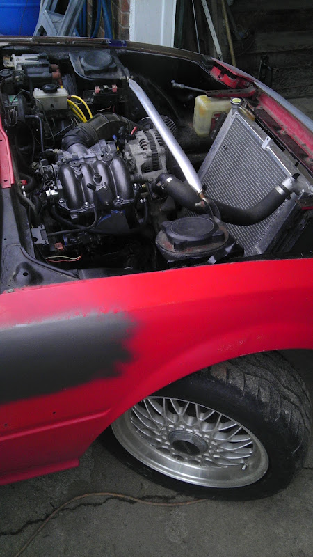

Today was a good day. "S5-SA" is up and running. What started as a stock s5 NA engine/stock harness/stock ecu build has turned into a full standalone and future turbo candidate. This is a '79 SA with a full FC subframe, brakes, and steering, and 4-5lug adapters in the rear with a Haltech e6k. It is a 6-port block with turbo manifolds, and TB.
There is a lot going on in this picture.
Expect a future build thread from jfaplanet and Rx8FCMel in the future.

Kewl.... Ditch the E6Krap and get a real ecu
Old 02-05-2012, 08:17 PM   #3
Budget wont allow a more expensive ecu... Maybe in the future. Still miles ahead of the stock ecu in terms of simplicity and control. Baby steps man! Baby steps!
Old 02-05-2012, 08:48 PM   #4
helltech e6krap is a step backwards though
e6k is rockstar. I got mine for $450 with a terminated FC harness. The software is ungodly simple to use. I'm able to run the software on a free laptop. It may not have the bells and whistles of your $5000 Motec, but it gets the job done just the same.
If by rockstar you're referring to the hairbands of the 80's that we all laugh at now, sure... I'll agree with that 100%
Hey now... I'm running a Haltech in the Turbo 'Vert. Stock turbo, stock... ish intercooler, ID 725/1000 combo, FFE trigger kit, stepper motor BAC, and datalogging out the cornhole. PS2000, I like the software, the wiring is not exactely the way I would've done it but I'm working on in... well, actually I'm working on the PS1000 we have going into and FB and it's not the worst. Not tefzel but it will certainly do.
Originally Posted by beefhole View Post
I run an E6k and I am saddened by the hate
It also came with the car years back
works for me!
Soooo many better options out there without breaking the bank. My personal reason for the hate lies in the software, dated... MY GAWD YOU NEED DOS TO TUNE IT!!!!!!!! the trigger pickups aren't the best, the datalogging is comical, and the resolution isn't adjustable, etc etc etc.
I'll admit though, I'm biased. The first real experience I had with an ECU was the MoTeC V3... from install, to setup, to tune, to driving it for 4 years.
On the otherhand, we had a TII with an REW and a 4bbl TB, w2a intercooler, huge ass turbo etc etc etc... it took a while but I was able to get that thing tuned to start and drive like a street car on the stock ecu... so it's capable sure, but its still the e6Krap
