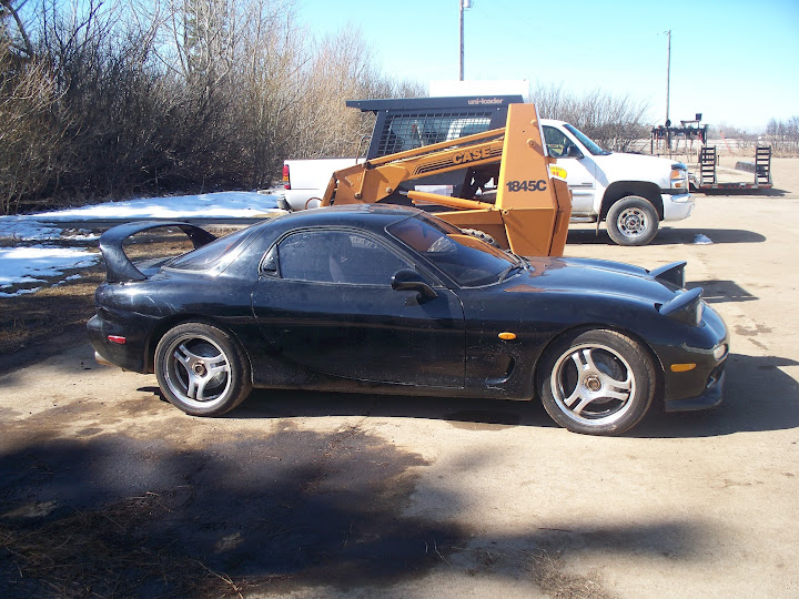

I bought the FD in 2011
I picked up the FD for 3000$, it idled a little ruff and isn't the most beautiful specimen, I started out with a full rebuild using the atkins rebuild kit. I also deleted and simplified as much as I could(some regrets here).
anyways here's the car

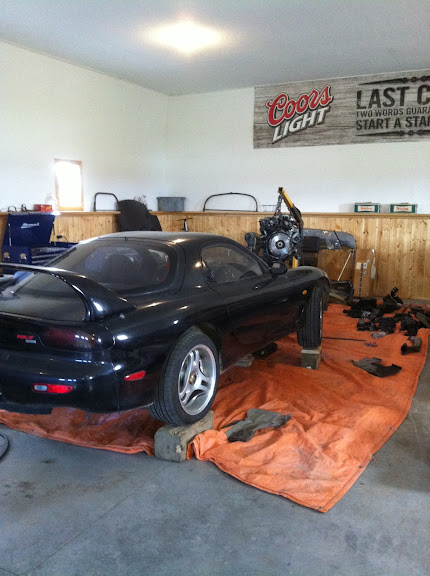

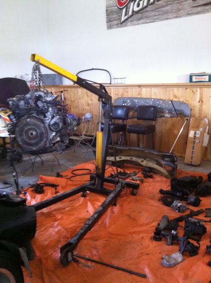

Started pulling it apart and pulling the engine early summer 2012.
The project got pushed to the side for most of the summer as I ended working on my truck alot more than I wanted.

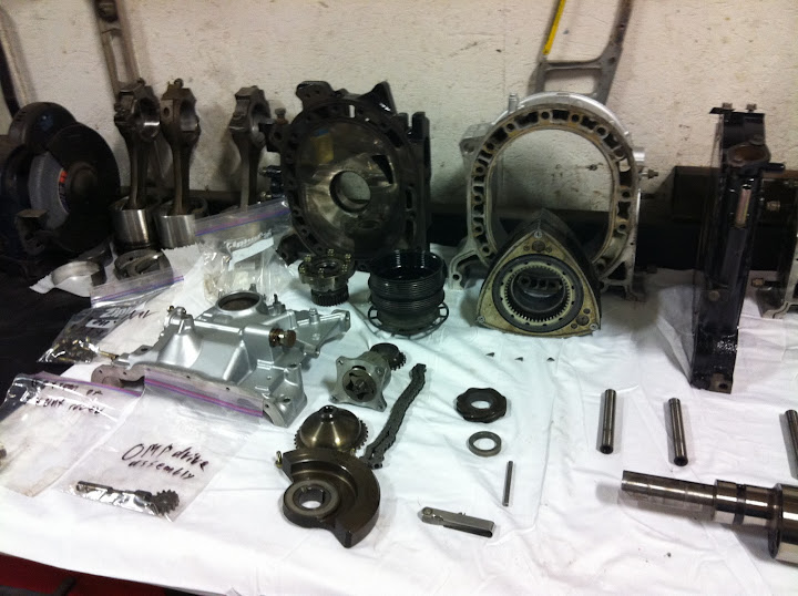

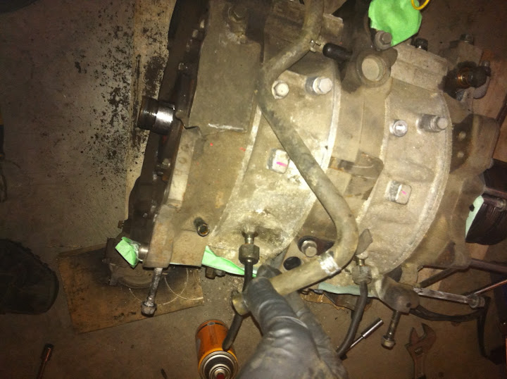

In September I got to pulling the engine apart.
at the end of September I disassembled the engine
The iron's

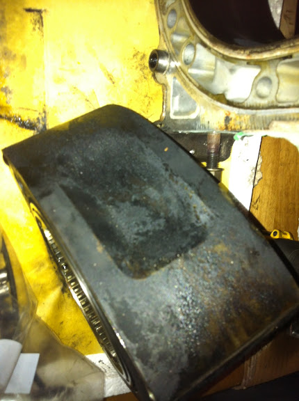

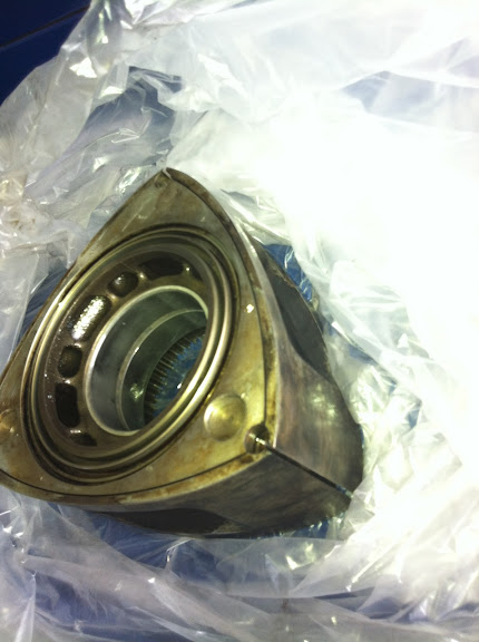

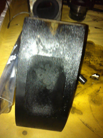

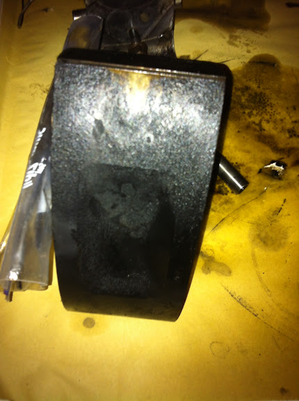

Some serious carbon build up on the rotors

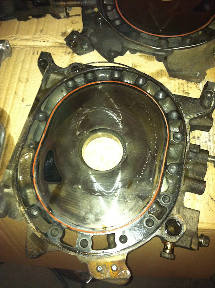

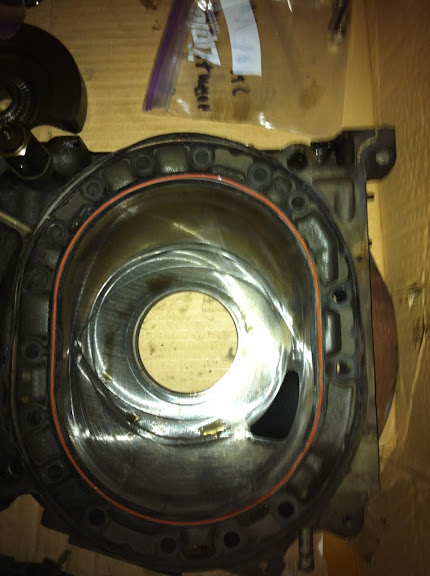

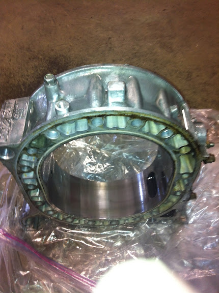

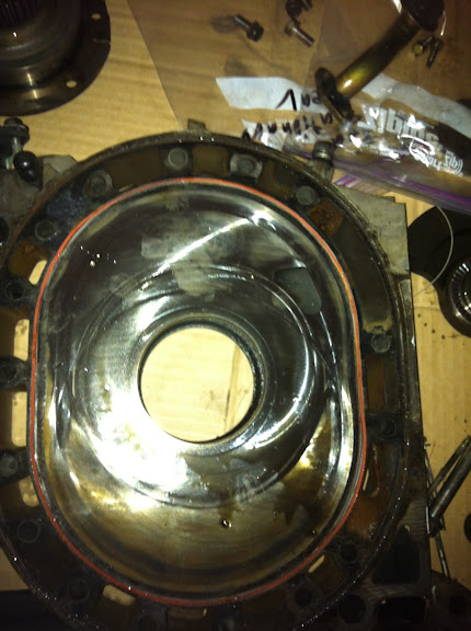

And the housings
and the engine in pieces

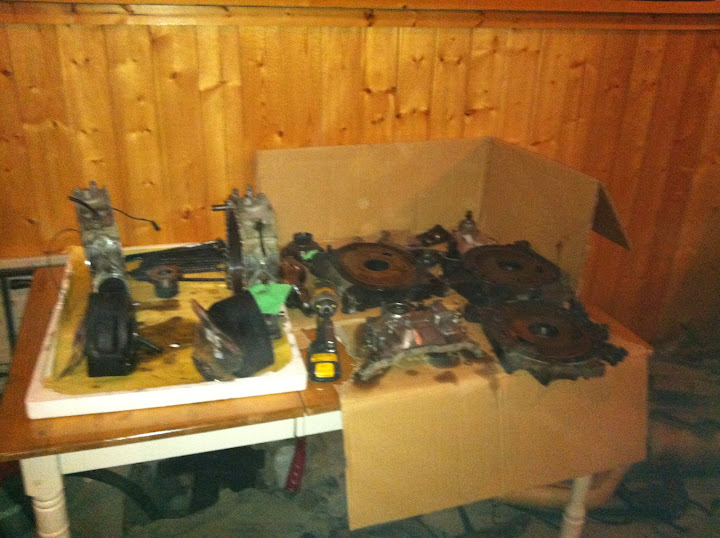

here's the pictures from cleaning
still needs some more cleaning but starting too look alot better
mostly just cleaned the crap off the outside at this point

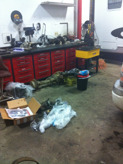

Started by moving all the parts and parts washer from the unheated barn into the heated shop.

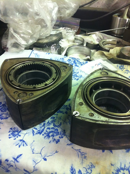

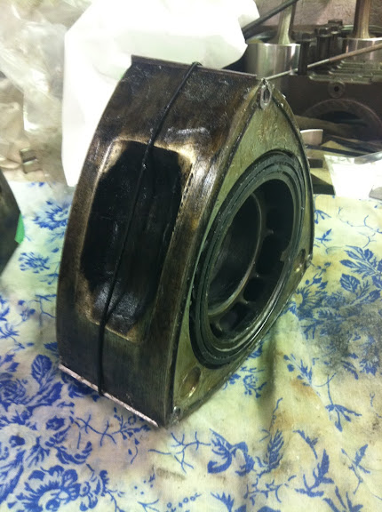

Prepping the rotors. Side seals ruffed into place on the front rotor
Then both rotors
Then grinding the side seals

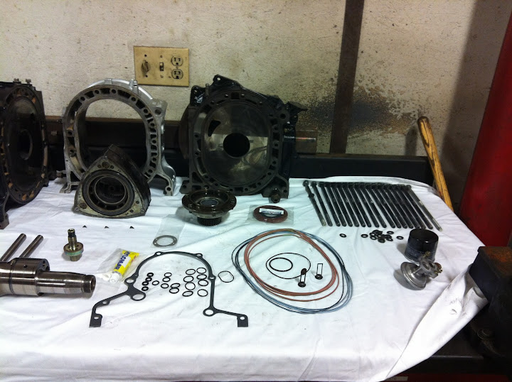

Weekend Later I started assembly of the engine.
Parts laid out

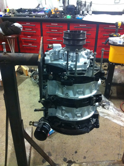

Oil pan on
Water pump painted
water pump on and put on my longer term engine stand. I didn't like leaving the engine hanging off two bolts.

I also hate how old and crappy this stuff seam, wish I would have ordered some stuff with the sound damper. anything you guys can think of locally that would work as a good replacement?
some pictures of the stock plastic coating coming off.
