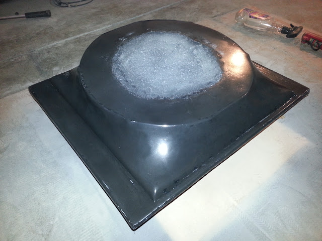

Finished up the clear on the mold last night:
It doesn't look particularly glossy in the photo but it's got like 10 layers of clear on it. If I get some time tonight I'll start building up the layers of mold release (just like wax). Going to a wedding this weekend in Seattle so I'm not going to get much done.

Got 5 coats of wax on the mold. I'll probably do two more for the maximum recommendation of 7. I'd still like to find some aerosol PVA or something similar. Can you tell I'm worried the fiberglass shroud is going to stick to the mold? In between coats of wax I started screwing with the front of the car in more preparation for the ducting.

7 coats of wax on the mold. I also picked up some PVA I'm going to try to apply with a spray bottle as I don't have a spray gun. Hopefully tomorrow I'll be laying fiberglass. The plan is for at least two layers of mat with another layer in the corners and flanges for support.

I got the fiberglass laid over the weekend:
As it's my first attempt it's nowhere near perfect but it should still work. I ended up using only two layers because I bought heavier mat. It just has to be able to hold the fan anyway. It was hard getting bubbles out because after laying about 1/2 the first layer my roller fouled up with resin and was pushing the mat around. If I did it all again I'd cut larger pieces of mat and do whole sections at once. Tonight I'll start trimming and sanding. If it turns out crap I'll just try again.

RETed
Posts: 1,813
Actually looks like a good job!
Yeah, I think you're getting a little paranoid about the mold release...
We went with the minimum 2 - 3 coats of wax and then a layer of PVA.
The release went OK.
I don't think you should have any problems.
Bubbles are due to the complex shape, so either cut the fiberglass mat smaller (not in your case) or use thinner, lighter weight mat - which would be the better option here and just run more layers.
Experience will tell you what you can and cannot get away with.
It comes down to getting corners and nooks / crannies to transition as smoothly as possible.
-Ted
Thanks! Yeah, 7 layers of wax was probably unnecessary when I used PVA in the end. That stuff helped out big time. It's fun to pull off too. A lighter mat would have probably been better. I'm not sure what weight mat I used but it's intended for boat repair so I imagine it's pretty heavy. I'll definitely use lighter stuff next time for complex parts like this.
