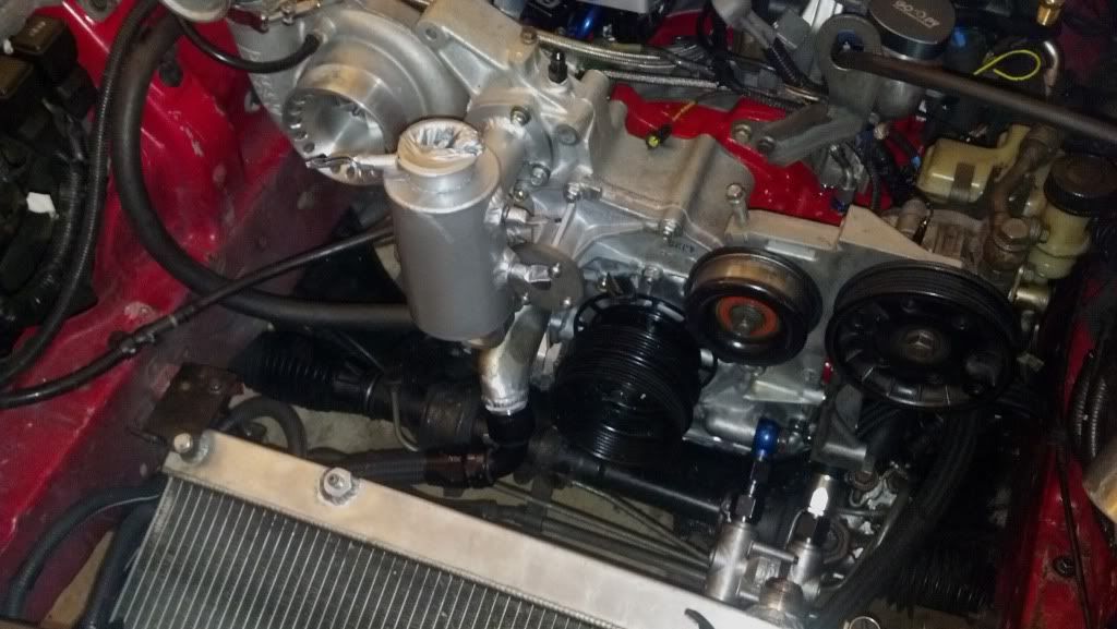

Had a little bit of head way last night. I spent the weekend down in Charlottesville taking care of some (looming) wedding planning. Sunday afternoon was for the car though.
Vlad came by and rescued me from my seized clutch slave cylinder, that was (surprisingly) a bitch to get out. So the clutch got fixed, then I focused my attention on the engine bay.

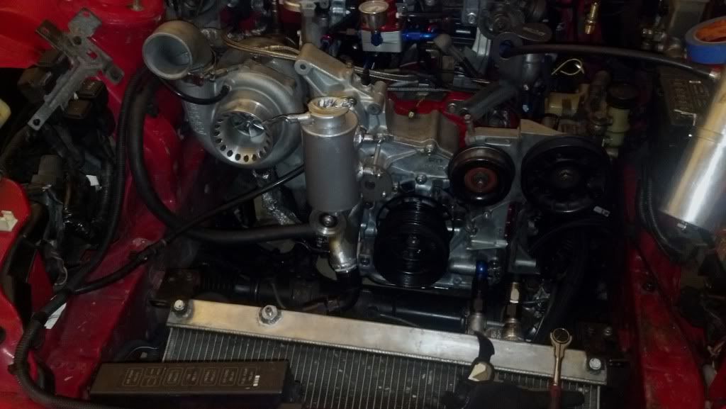

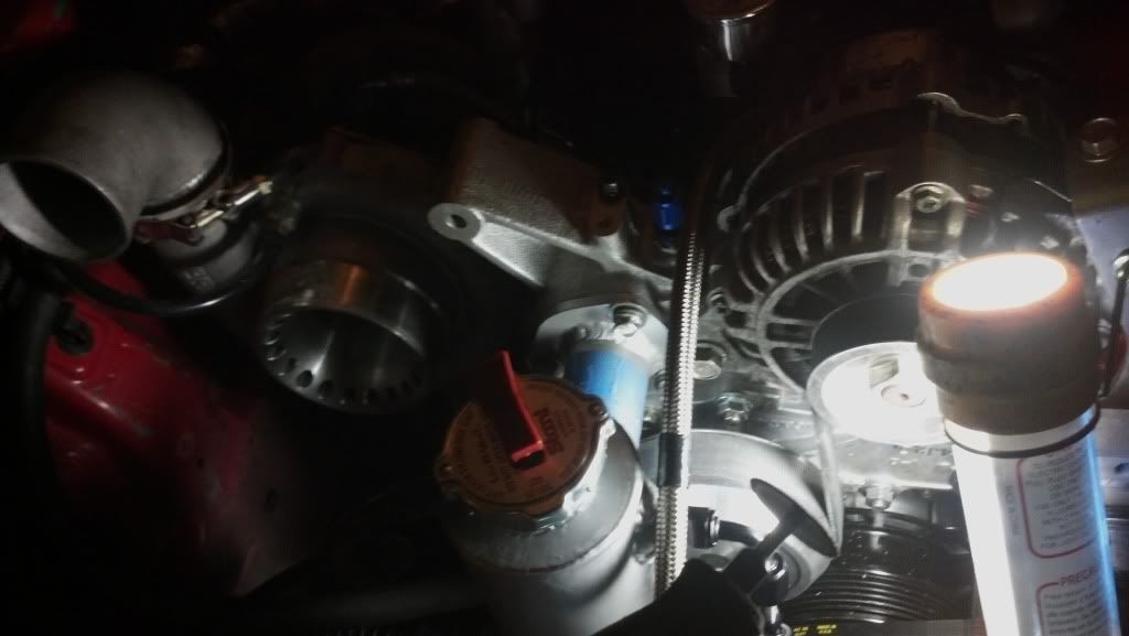

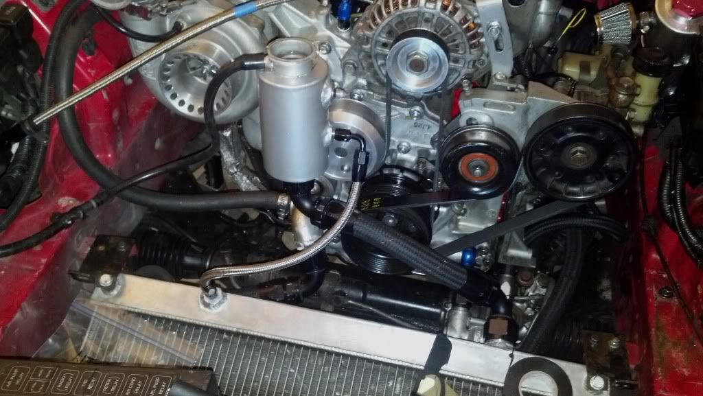

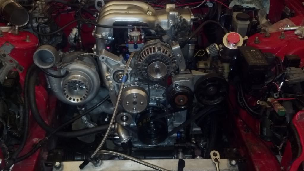

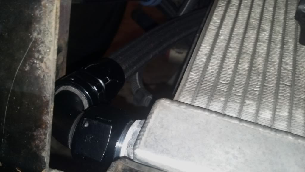

I flushed out the radiator after Brian (TitaniumTT) did some badass welding on it. The radiator is now rocking 2x -16 bungs and 1x -4 bung for the radiator hoses and an AST input (respectively).
Radiator fit in the engine bay.
The lower mounting point, and my (not so shiny) new radiator line.

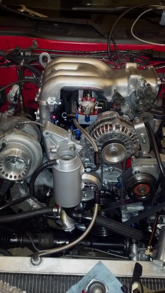

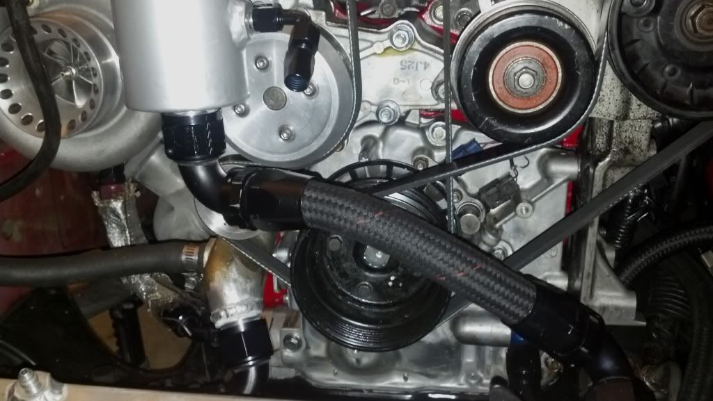

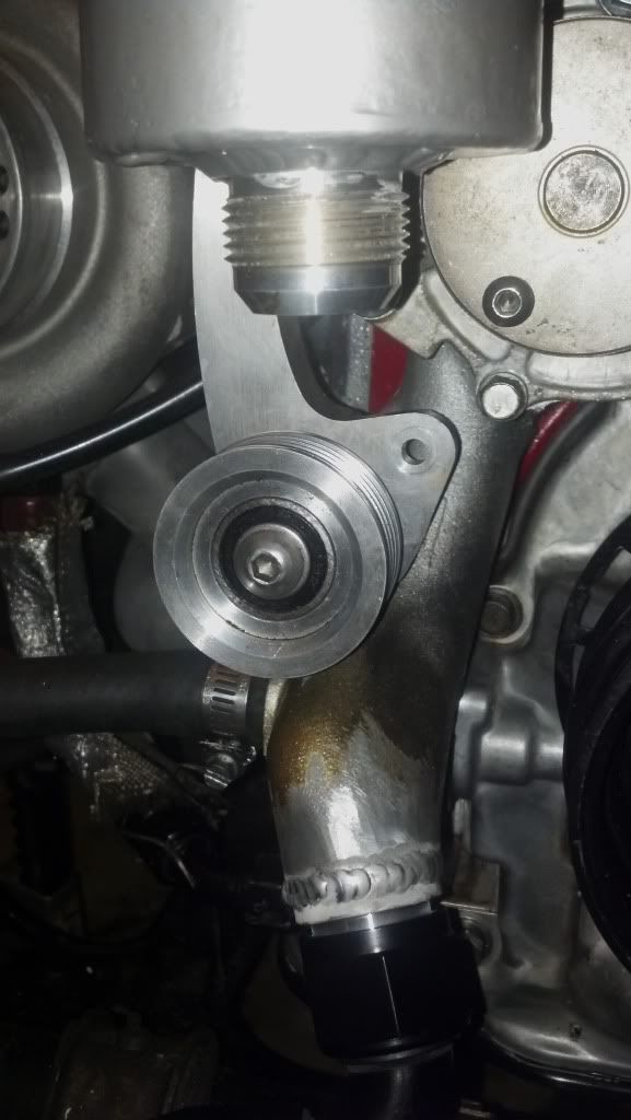

You might have noticed that I seem to be missing my T-stat/coolant filler neck. Technically that is correct... Brian wasn't satisfied with my old t-stat housing and AST arrangement, so he figured "what the hell" and decided to combine the two parts into one! I'm pretty impressed with how well it worked out, and def satisfied!!
Test fitting the new AST.
Here's where my "AST/Filler neck" will connect to the upper radiator "hose", with the Tweakit Idler pulley in the background.
Testing out the length needed for my upper rad hose.
This afternoon I finished putting the belts/alternator/etc on and gave the AST one more (last) coat of silver paint, than came upstairs to change out of my uniform. After dinner I'll go back down and cut my last radiator line, then modify my AST lines to fit.
Once that's done it's just a matter of mounting up the intercooler, installing the battery, then firing her up for her (second) heat cycle!!

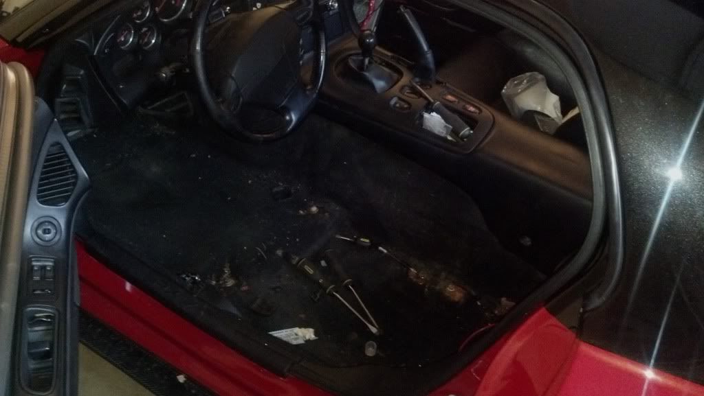

I finally was able to start working on the FD around 3pm. Here's how she looked when I started:
The engine bay was pretty much ready to finish getting put together, all it needed was for me to finish cutting the upper Rad hose, trim down the two AST feed lines, then mount the AST/IC/Battery.

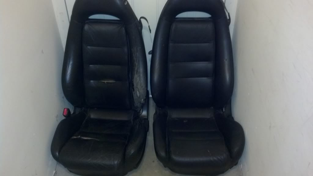

I found some long lost spare change under the drivers seat:
Here's a side-by-side of what WAS in there, with what WILL be in there:

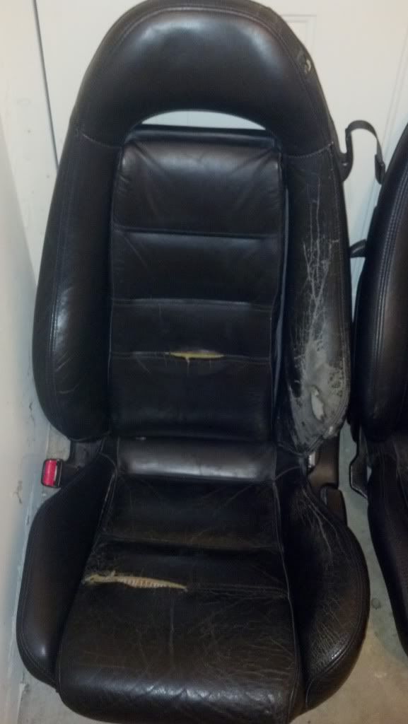

The left is my original, 1994, leather seat. The right is a "passenger" seat that I purchased while living in England about 4 years ago. Since the UK "passenger" seat is our driver seat I think it should work out perfectly
Here's a bit closer of a look.
Out with the old:
In with the new:

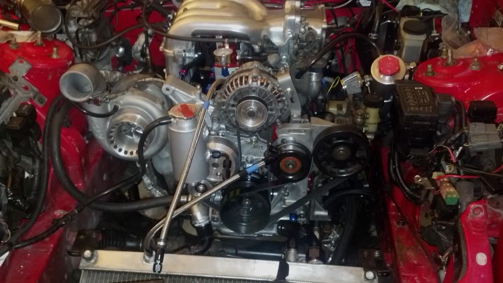

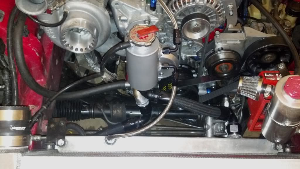

I mounted the AST up one last time to confirm how long the upper radiator hose needed to be cut.
Then made that shit happen

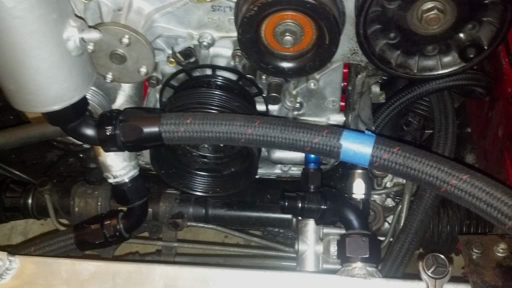

Next it was time to get those AST hoses sorted. Too easy right? Should only take about 5 min with the dremel to cut the hose down, then it's just fitting the hose ends on and we're moving on!!
The bottom hose got the memo, went smooth as you could want

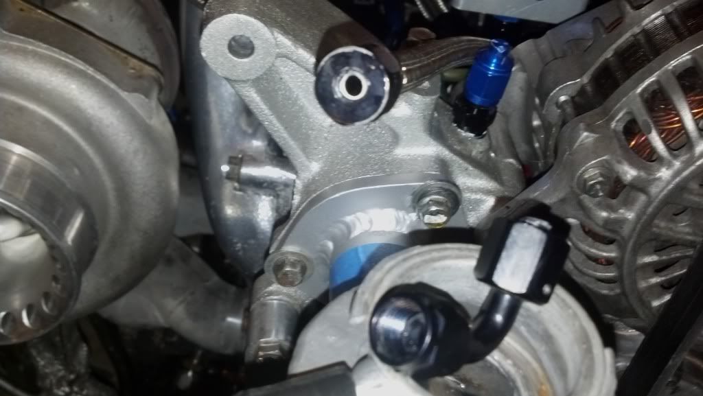

The upper one though... that fucker had other plans! The upper one is/was attached to the rear iron at the port that (used to be) is normally used for the coolant bypass in the Throttle Body. That is the highest coolant point in the keg and should (naturally) be used to feed the AST since any air bubbles in the engine will rest there.
I decided, for the sake of saving time, that I would just cut that hose while still attached to the car. I didn't really feel like removing the UIM and digging through my fuel lines/engine harness to reach where it was mounted.
The cutting went fine, bu while I was threading the second 90 degree -4 fitting disaster struck!
Right as I was tightening the fitting down it broke
The damned insert just sheared right in two!!! I had a hardcore rage-face moment because that was my only remaining -4 90 degree hose end, and a straight fitting would NOT work!
You can see the broken fitting, and the piece stuck inside the hose here.
At this point I damn near called it for the night. A text was sent out to a couple of the guys who have helped out lot with this so far, that basically consisted of the above picture and the word "fuck" used in a manner that had it fit every part of speech. Think Boondock Saints..
I had a beer and, like any good Enlisted Sailor, hatched up a solution while throwing one back to sooth my nerves.
I had an idea, and only one chance to get this right.. I had one straight -4 hose end left, the 90 degree fitting currently attached to the hose, and just barely enough left over hose that I would be able to fashion a replacement line.
So off came the UIM and the existing AST hose, it was time for a swap.
Here's the hose that WAS on (on the bottom) and my last bit of -4 hosing that would either save, or ruin, my day.
Thankfully my idea worked perfectly!!

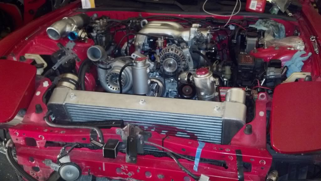

The UIM went back on
Then the IC went in (finally)

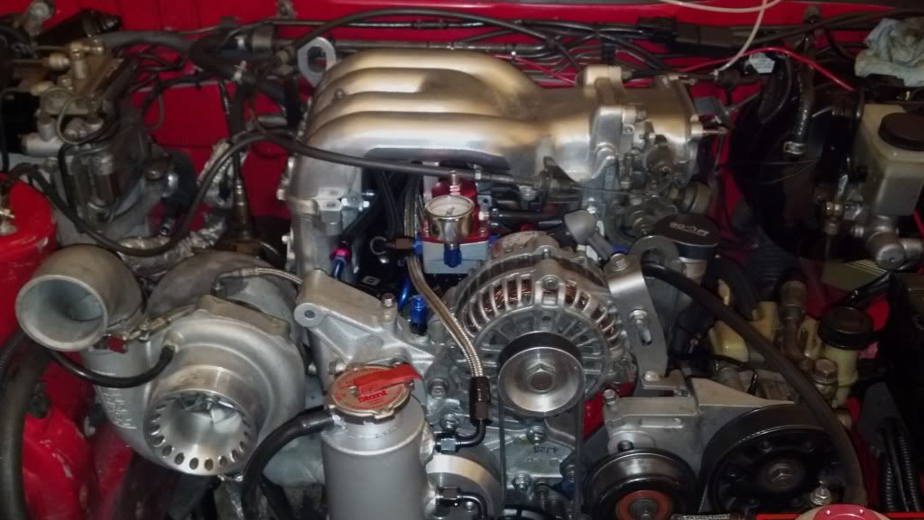

The battery went in and here's how she looked at the end of the night:
I closed up at about 10pm, all I have left to do tomorrow (hopefully) is hook up the IC piping, install my new drivers seat, and start those heat cycles!!
