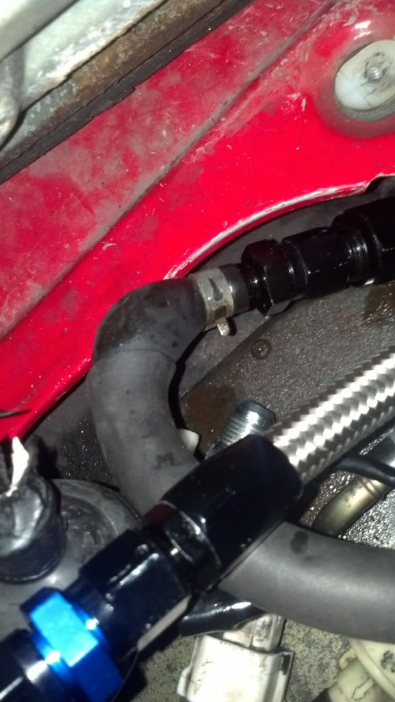

Here's the other problem I found... While doing the test I found a distinct bulge in the short length of rubber fuel hose on the feeding side.
THAT is not good. I'm debating on whether I should replace that with fresh rubber hose (we're holding off on connecting the AN line directly until we make and install the swirl pot) or use a very small but of nylon braided -6 hose that I have left over. The internal diameter of the -6 is about identical to the outer diameter of the stock lines, so I'm thinking it *should* seal tight with a worm clamp...
I'm def open to suggestions from the pro's on that though ^_^

I would replace it. You can get a rubber fuel hose from advance for pretty cheap. Cut it bring it with you get the length you need and some band clamps and call it a day.

Done and done =) I neglected to take some "after" pictures because I was too intent on going straight to flow testing the fuel pump, then taking the car for a drive to make sure everything was good =)
I put the new length of 5/16" fuel hose in (I got rid of the 6" double loop and just went with a straight shot from the fuel pump to the feed line) then fired the pump up and checked for leaks. Tightened up the clamps a bit more after spotting a leak and proceeded with the 43.5psi flow test. I was kinda worried that when I cranked the FPR up to 70psi (it wouldn't push higher than 70psi by the adjuster on top of the FPR) but the fuel line held fine and was leak free =)
