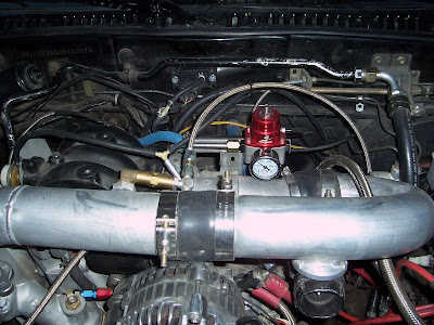

I decided to upgrade the rest of the fuel system now. Running the Aeromotive FPR and AN fittings to the rails. Staying in series now to save money, but will eventually run parallel.

Fuel system is just about there. I went with the Aeromotive Fuel Pressure regulator and an running -6 fuel lines to the rails. I will be running -8 to the tank next, and then changing the fuel rails to run in parallel.
Now I will be able to tell if there is an issue with the fuel pressure at a glance... Finally. This could've saved me a lot of guess work earlier.
