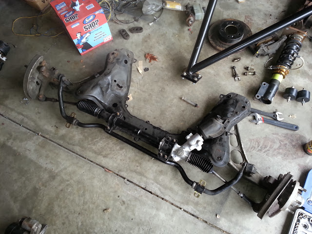

Back before the holidays I finished swapping the front subframe. Empty red car:
Removed with steering rack:
In its new home:

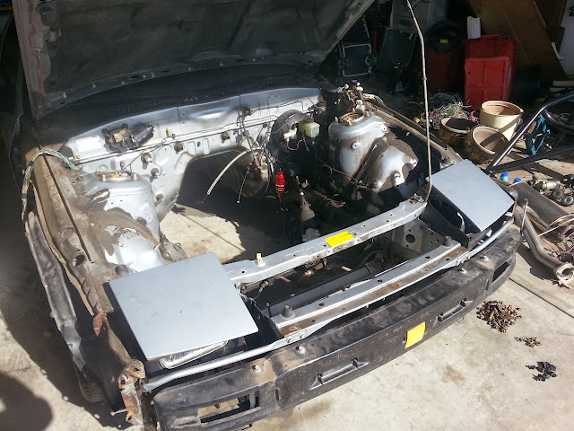

Empty engine bay:

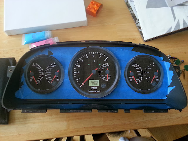

Other than that I think I've found my new instrument cluster setup:
Speedhut gauges. 3-3/8" dual oil temp/pressure, 4-1/2" tach (mine will be 10K RPM) with inset 120 mph GPS speedometer and indicator and hi-beam LED's, and 3-3/8" dual water temp/fuel level. The voltmeter will just have to be separate in the console with the wideband. If anyone's interested I will be selling my Marshall Instruments gauges.

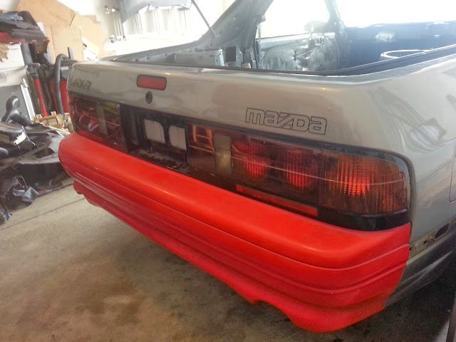

The fitment is a little funny, which makes me wonder if there was a rear-end collision at some point.

The duct-work is clean, but not complete:
I need to make plates to seal up the sides around the oil cooler and I may try to change the inlet to take full advantage of the opening in the bumper cover (conservation of mass and all that). It's still better than what I could do without having a metal brake.
Mocked up the engine to start figuring out where all the wiring's gonna go. Chris Ludwig of LMS Motorsports will be handling the engine harness while I'll be doing the chassis side.
Looks like I got a little carried away with the fan shroud. Depending how I orient the shroud it can be as little as 1/2" away from the front swaybar and about a 1" from the main pulley.
