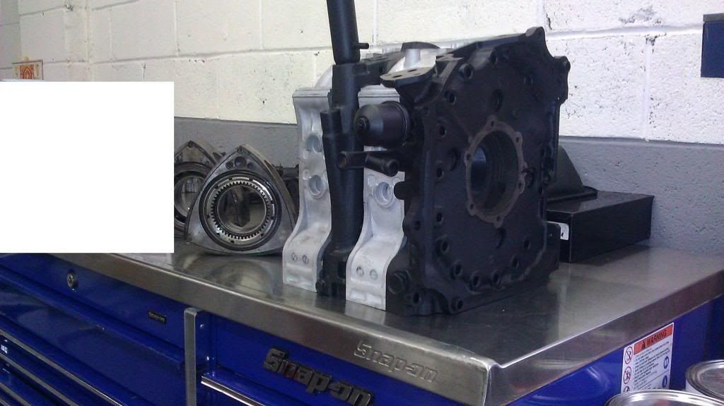

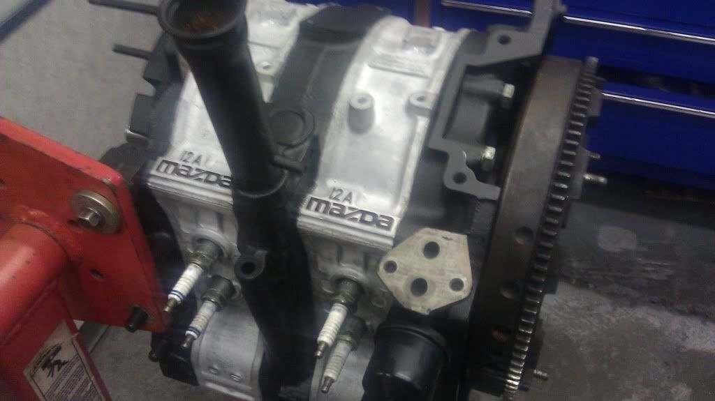

got mine done.
here is the before and after. thanx for the great work guys!

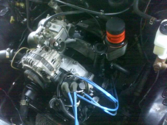

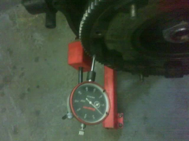

12A bridgeport

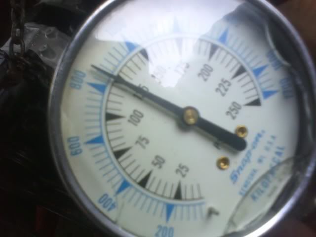

I just did a 12A bridgeport for a daily driven Mazda B2200 pickup. using Goopy's refinished rotor housings with apex seals. I wanted to do a compression test as close to real numbers as possible. I did not lube the side housings with oil and I did not lube the rotor housings with oil. basically a dry build and dry test. I did not want the lube oil to add to compression numbers. engine made 125psi equally on both front and rear rotor. enjoy the pics..
