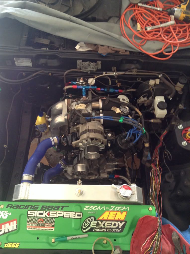

Started reapplying ALL the bolts under the hood as well as starting a wire tuck. Yes..... It sucks! I have stripped the harness down and started cutting wires. We will see how it turns out. Headlight wires are ran so far.

Still need to figure out what to do with all these wires...
![]() And try to remember what these went to lol ![]() |

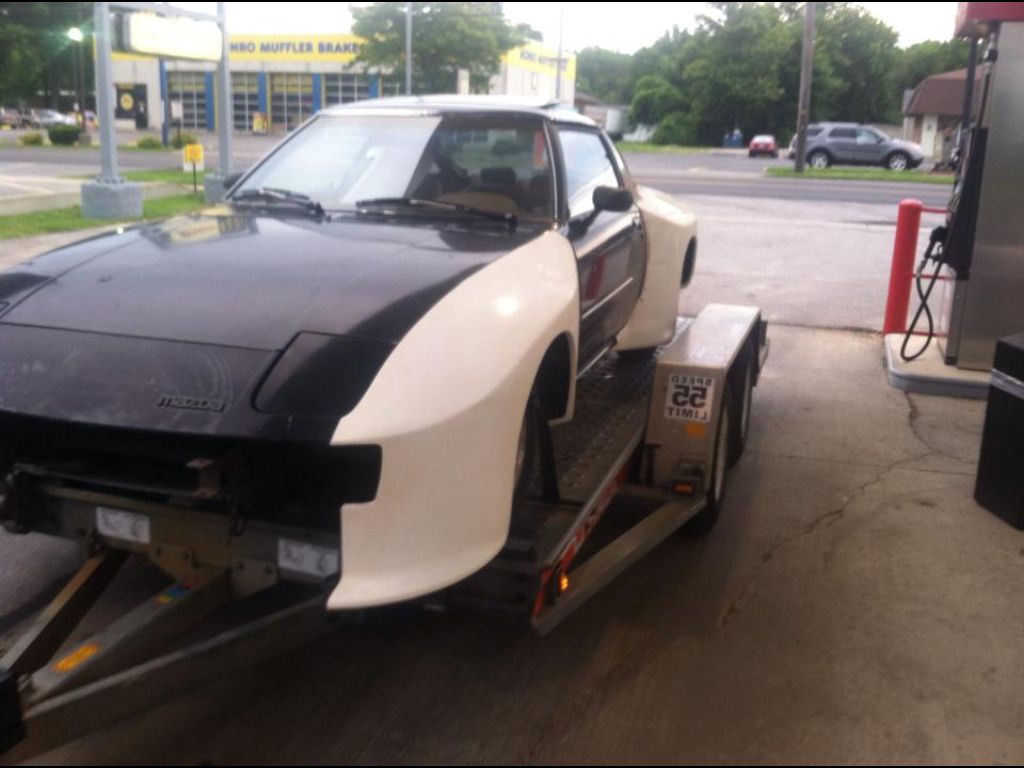

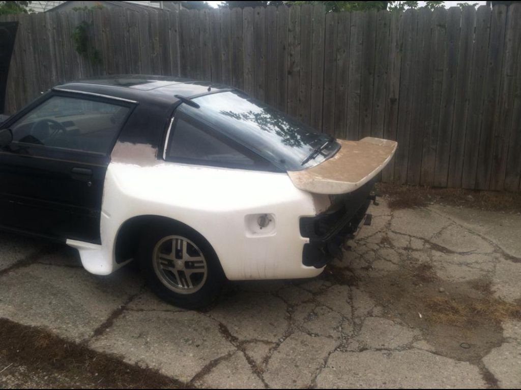

So I was headed to a buddies house to work on my awesome girlfriends newly acquired SA and I saw what looked to be an rx7 with a body kit....... Turns out it was! Now I had a widebody at one point and like an idiot I got rid of it and now I'm building the same car. Long story short they no longer sell the old kit I had and I couldn't find one anywhere. This rx7 just happened to have the very kit I needed....
I immediately turned around and went back to look at it. The owner was not around, but his daughter was. I told her I was extremely interested in the body kit and gave her my number. Then I looked it over for a few and snapped a pic. ![]() The next morning the old man called me and after a few minutes of talking he said that he was not interested in separating the kit from the car at all. So I bought the whole car..... ![]() ![]() ![]() ![]() ![]() It's a 1982 GSL with 153,000 miles from Tennessee. |

Not a huge fan of the tan, but I kinda like it...
