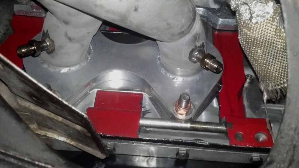

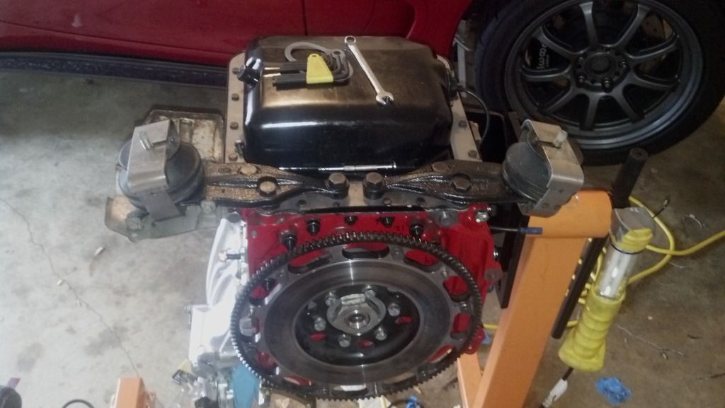

David Garfinkle is the freaking man!! I contacted him about his oil pan braces and he agreed to make another batch of them for me if I could help spread the word to other owners in the community. When I received his Oil Pan Brace I, like many owners before me, was incredibly impressed by the high standard of his workmanship. Needless to say, I feel sorry for anybody who doesn't have his brace and who missed out on this production run, since it seems they only come about once every year or three now.
