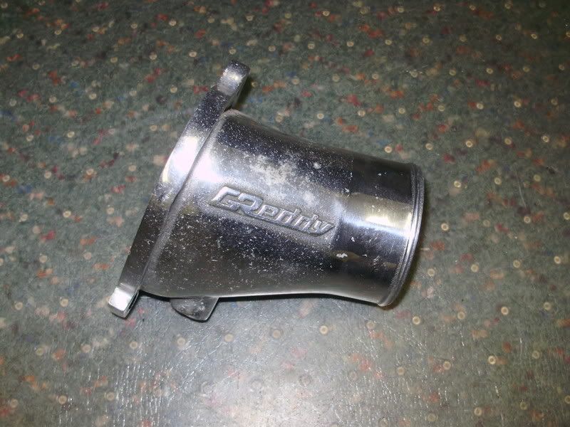

2. HKS Super Blow Off Valve and Greddy Compression tube (Thanks to SpooledUpRacing).
Everything less the compression tube is going on tonight (no front mount as of yet)

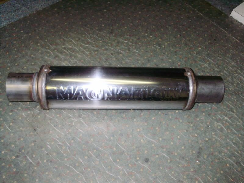

Received my new muffler today, so the babies of the world can stop worrying about their ears bleeding.
Magnaflow. Stainless steel, and dimensionally its good for clearances, etc. The straight pipe thing had to come to an end.
Old 09-16-2008, 08:18 PM   #15
Muffler installed! Sounds much better and now i actually can enjoy driving it. Its a good straight through design with lifetime warranty.
