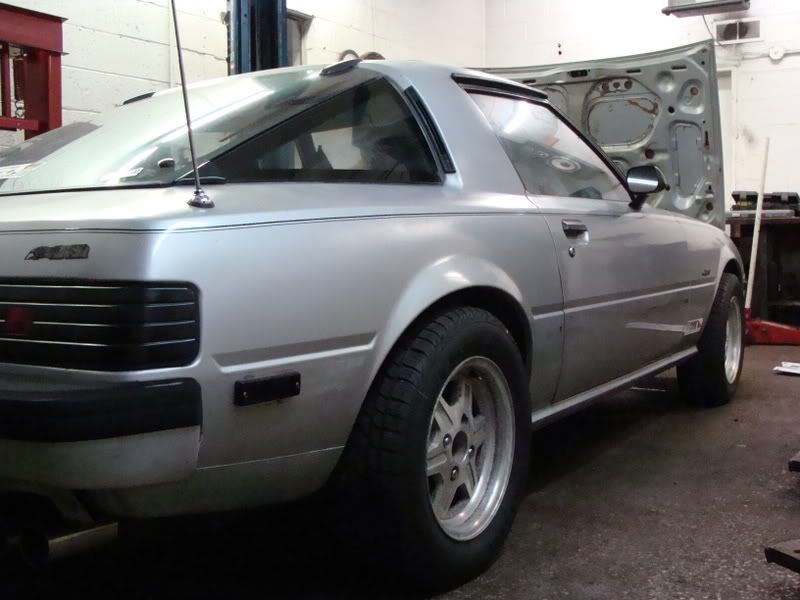

Old 09-07-2008, 10:21 AM   #28
14" Datsun 280Z(x)? decently common. I have a 205/60 tire on them.
