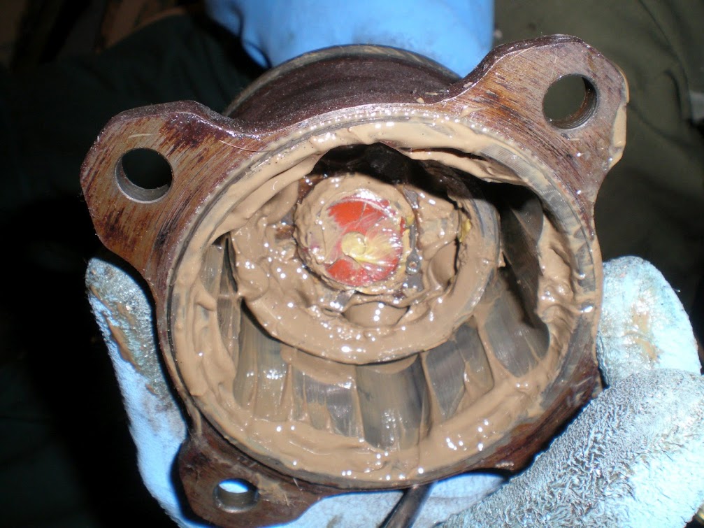

It was then time to address the half shafts.
this was the driver side shaft where the end cap was forced out...who ordered the pudding?
Step One: dissasembly There is a circular retaining clip just under the inside lip of the cup. Simply pry that out with a pick or screwdriver...
and the shaft should slide right out , and drop nasty greasy balls in your lap....or onto your prepared work surface.
Step Two: Cleaning I don't know the best substance to clean off old axle grease in 20 degree weather, but I know what it ISN'T....Acetone. That's all my buddy had, but I ended up resorting to dish soap and a pile of paper towels.
Step Three: Reassembly Now that everything is clean, time to dirty up again with fresh grease. I went with the heaviest synthetic import specific grease I could find at the parts store, I think it was made by valvoline.
Don't forget to re-install the retaining clip
This was my "solution" for that end cap that was forced out (because i couldn't source another cup and couldn't afford a new axle). The mating surface was coated with RTV, in retrospect perhaps jb weld would have been a better option....time will tell.

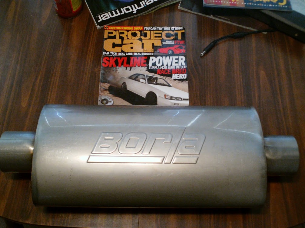

Riding around like this (open downpipe) got load pretty quick.....and pretty annoying a little while after that.
Enter another amazing deal, a buddy of mine sold his T2 but kept the RB exhaust because the buyer couldn't afford both. He packed it up and stored it but never actively tried to sell it. Fast forward a few years.....I happen to mention I'm in the market and he "thinks he may have a turbo-back FC exhaust he'll sell me for $250"....ok. Well turns out he lost the midpipe so I got it for $200....even better!
Of course not having a mid-pipe did present a small problem, but nothing that couldn't be solved with this. Borla XR-1 3in inlet 3in outlet .
As I don't weld it was off to the local muffler shop to bring it all together
Stock turbo outlet --> 3" downpipe --> 3" Borla XR-1 --> Ypipe --> Dual 2.5" Racing Beat cannisters
Actually turned out to be a bit more quiet than I was expecting/hoping for...oh well stealth status.

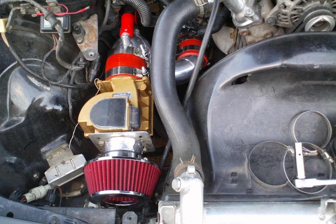

Once the exhaust was squared away it was time to turn to the intake. The stock turbo inlet duct was full of cracks and beyond repair so I picked up the Corksport aluminum TID. Pretty well made piece. My only gripe was that they didn't have any black couplers at the time that I orded so i ended up with red...oh well.
