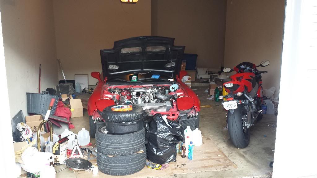

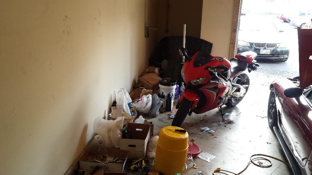

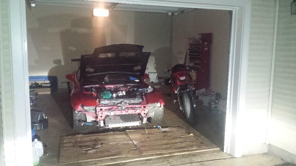

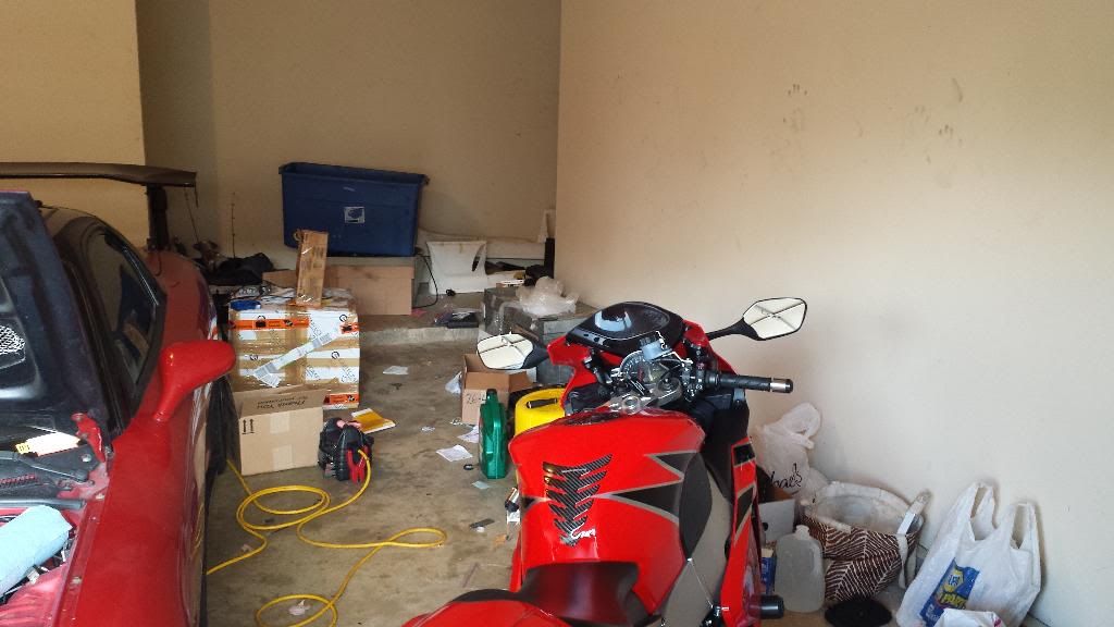

Here are some random Before/After pics of my garage, and it's clean up
Before:
After:
Just gotta pick up some storage shelves and make a work table, then I'll be ready to get down and really start!! lol

You sure you have the same place? Let me know when you want to tackle that pig. I need some snuggle time with Brian under a car.
