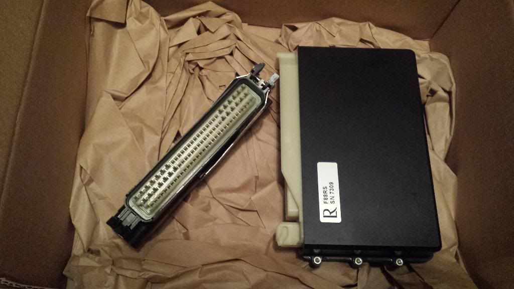

So I was reading over the FSM this evening when there was a knock at my door....
It was the Fedex guy
He brought me a little something-something..
A Wild Life Racing ECU has appeared!

Nice ECU Levi

Thanks Mike
Now if only I hadn't recently gotten slammed with life expenses that stole all the money I was going to use for building this things harness (and engine)!! lol
Make sure you pull all my pubes out of the connector that I left for you
