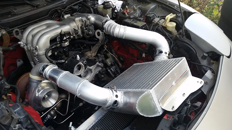

Finally got a clear day to take some pics of the finished piping.

Nice work and I'm a newb to all this turbo stuff, but is that setup going to be too rigid?
Won't the engine moving a bit cause some stresses on the pipes or do the connections
and rubber isolators on the intercooler deal with that for you?

The radiator and intercooler are both completely isolation mounted. The Vanjen clamps also allow for ~15° of angular movement and ~.5" of axial movement. There won't be any problems with stresses between them due to engine movement.

I still say ditch that shock looking torque brace and brace the engine off the bay or build a tri-point strut/firewall brace
Old 11-12-2015, 10:53 PM   #5
And yes.... still looks good. Did you get a chance to measure to see if the TiAL BOV will fit?
Old 11-13-2015, 12:43 PM   #6
RXtacy
RXtacy's Avatar
Location: Rockville MD
Posts: 456
Why, because of engine movement?
That damper is jacked up so needs to go anyway, but I'm not real excited about the idea of hard mounting the engine.
Haven't really mapped it out, but it's not looking good. The existing Greddy RS is 3.5" tall from the flange and it is practically hitting the shock tower. With the dimensions you gave me the TiAL is 3.35" without the fitting. All the fittings I have found are .5" tall. I just don't think it will work in that location.

Yes, because of engine movement. You can grab some Energy Suspension sway bar end link bushing, or some generic bushings that you could use to isolate it. It will keep the axial rotation to a serious minimum while not creating additions to NVH
I'll have to look at the pics again, but IIRC the TiAL BOV can be sent pretty far into the elbow.
Or just sack up, weld the elbow shut, and put the TiAL on the charge pipe.
Or just get an EFR since it has the BOV built in. But of course I'm biased LOL
You seem to be under the impression that the damper was soft and highly compliant. It was not. I'll look into the sway bar bushings.
Yes I saw that, but it's still pretty tall.
Has nothing to do with my sack, I don't think a frankenstein patch will look good. I'd buy a new non flanged elbow if I was moving the BOV.
Hmm re-do turbo manifold, hardlines, hot side charge pipe, or move a BOV... Tough call
I know! Totally worth it bro. LOL
Old 11-18-2015, 01:51 PM   #11
Frankenstein patch wouldn't be seen though. After its welded grind it down, sand it, do the same to the inside, then we Powdercoat it, never seen.... Or yeah, but a new elbow works work.
Remember my elbow started off as the same as yours, lots of cutting and welding etc. Took a while but it looks like a cast piece again
