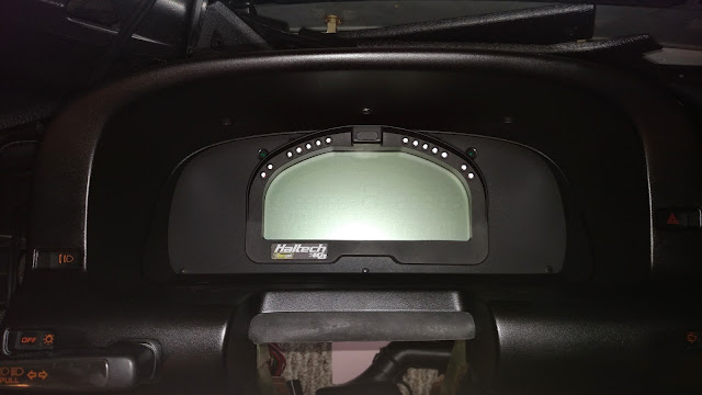

I finished some of my interior projects. Radio delete plate with USB ports for the Haltech and RacePak:
That blank space in front of the console:
The switch is a double pole, momentary switch for the Racepak. Last is the instrument cluster:
Can't really see but I shaved off the holes for the rear defroster, cruise control, and rear wiper.

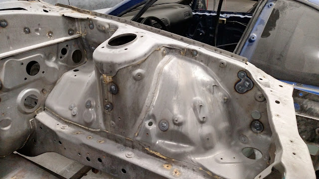

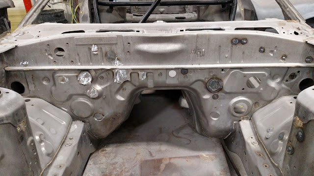

Snapped a few pictures at the body shop. My project got pushed back so they've only just started working on filling in holes in the engine bay.
With the exception of most threaded holes, I had everything that's no longer needed shaved. Why leave the threaded holes? I figure it's best to allow for the most adjustability in the future. I'm not going for a tucked/shaved look anyway.
I just finished doing this for the first time. Good luck with it. After the fact I regret spending so much time on it, but I guess it was kind of worth it. I'm sure yours will turn out better than mine did.
You definitely took it further than I am. For the most part I'm leaving all the threaded holes in case I want to move things around in the future.

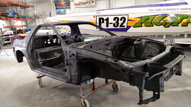

The body shop is prepping for paint so they needed all the body parts. I stopped by yesterday to drop everything off and took some pictures:
The body is sealed inside and out.
The engine compartment needs a little more seam sealer before any color is sprayed.
I had them bang in one area of the passenger's side of the transmission tunnel. I didn't like how close the Defined Autoworks exhaust manifold was to the body. This won't be noticeable under the carpet.
The shop recommended was bedliner on the bottom of the car. It's thicker and heavier but is MUCH more durable than traditional rubberized coating.
I'm not having the interior painted so it'll stay the dark gray/black of the sealer. This won't be noticeable with the interior put back together.
It's hard to tell from this angle the fenders have been rolled and pulled 1 in. This looks much better than the roll/pull I did on the red car.
The colors is going to be Magma Orange, color code LD2C. It's the VW/Audi color used on the Fahrenheit edition Golf GTi's.
