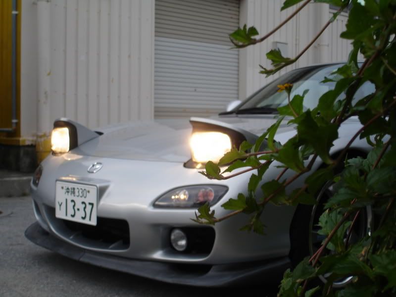

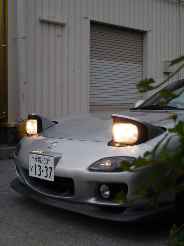

I got the car in July of 06. That same month, a friend pushed me to enter an Exciting Gymkhana event while we were on the 2nd to last Sunday drive. I did and haven't missed many events since. I swapped the stock (BLOWN) suspension with some HKS crap coils from a car that was getting junked. After, I just continued to drive the car. I was balls deep in college at this point and didn't get out much. No night drives or mountain runs for me.
OLD PICS!!
and a couple shots i thought were cool

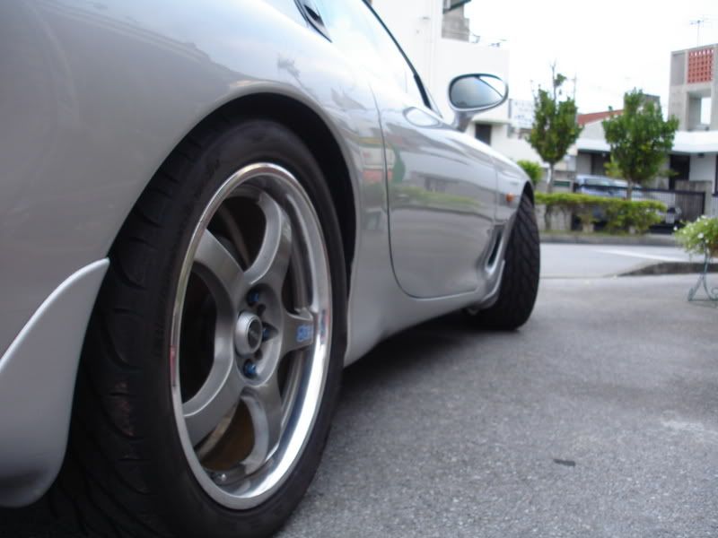

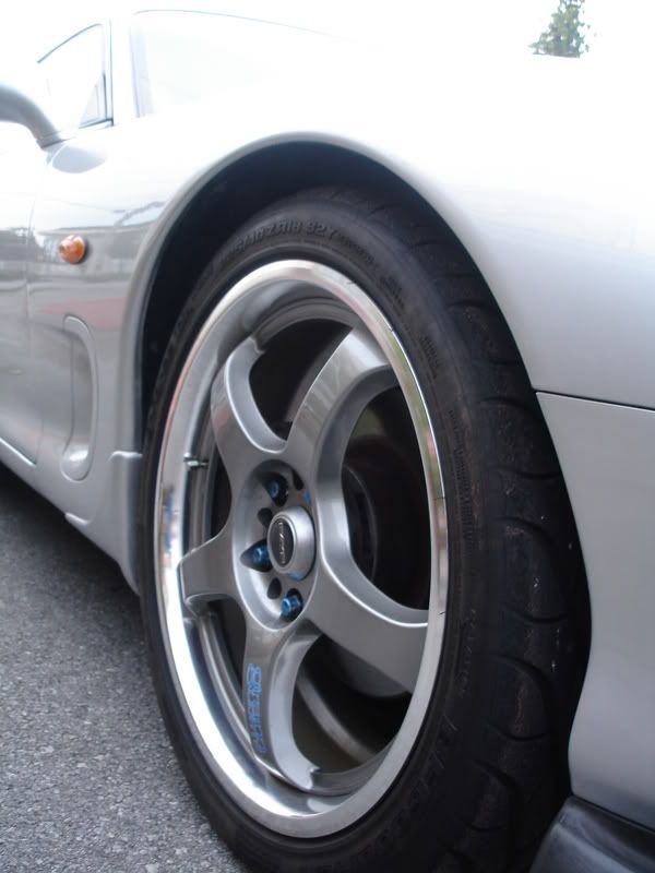

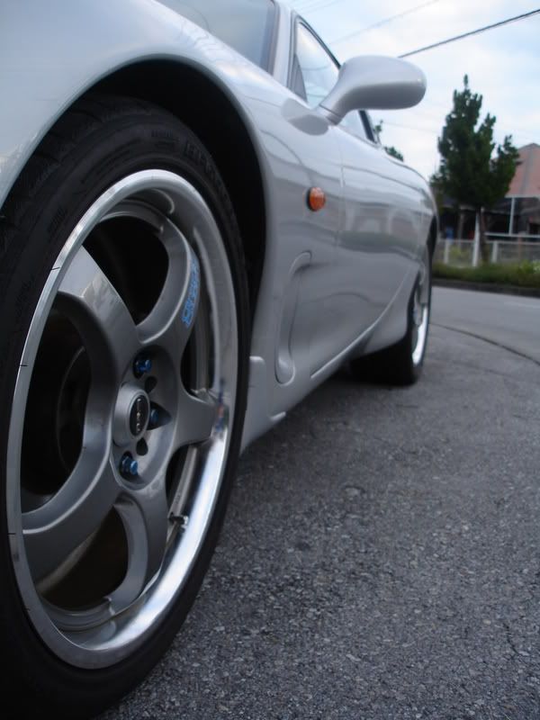

Shortly after replacing all those parts, I was on the road again. (Thanks Nate, Scott and Iggy) This time with a stock rear sway bar. Following that, I upgraded the brakes to Hawk HP Plus pads, Goodrich Stainless steel lines and Toda Fightex Coilovers. I also replaced the heavy 18 inch rims with some 17 inch stock 2000 FD Type RZ wheels made by BBS. I really like the style and color and they look really good on the car. Unfortunatly, they are stock offset and sit a bit sunk in. I have 15 mm spaces in the rear and will eventually get around to pushing the fronts out a bit as well. I coupled that with a set of 225/40/17 Front and 235 40/17 rear Potenza RE01r's .
