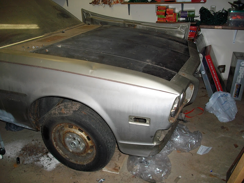

Figured I might well get a jump on things, so this is what's going down. I am picking up a 1976 Mazda Cosmo (RX-5) this weekend. It is partially disassembled, body solid and everything is there. Including a bunch of NOS extras.
Right now here is a teaser of how it sits:

The car has a 12a in it that was installed by Mazda back in the early 80's. So no 13B 4 port twin dizzy. It also has the 'better' electronic dizzy in it. This is one of those 'ran when parked' deals. He said it really did run great when he started to take it apart to address some issues. He has put oil in it and turned it by hand a few times a year. So it might be able to be brought back to life.
First off however, I am dealing with the body work and interior. It really just needs a few small spots addresses and to the trim put back on. The interior is in great shape except for the dash. For now, I will get a dashmat until I can redo it myself.
Next, I am addressing the suspension and brakes. I am under the impression that 84-85 from strut/spindle assemblies will bolt in, and give me many more options. From there I can get the RE-Speed FC brake kit. The rear end is where I am in the dark. I know it has factory disc in the rear, but uses a drum inside the rotor for parking brakes. This is not ideal. If I can get an FB rear end under it, I can again go with RE-Speed 5 lug axles and big brakes. From there, a nice set of 15's will be sourced (old school, or meshies).
From there, its power time. If the 12a is healthy, it will get a Weber carb and manifold, direct fire ignition, custom catback, radiator with e-fans and an FD alternator upgrade.
Right now I am debating on whether to keep the chrome bits chrome, or powder coat them black instead.

Wow. Info out there for the Cosmo's is so vague, and somewhat cryptic. I read a post where a guy said he uses FC struts in the rear (which doesn't seem possible), and a few references to FB shock in the rear. Nobody has an upgrade spring solution it seems.
Also, the factory bolt pattern is 4x120. Which sucks. Now, if I upgrade the front struts/spindles to GSL-SE, I can get some 4x120 to 4x114.3 adapters for the rear (since there is zero info on an axle swap). However, I have no clue on offsets.
This is going to be fun! I wish I knew if Billy could make his subframe for an FB fit the RX-5. R&P steering would be the shit!
