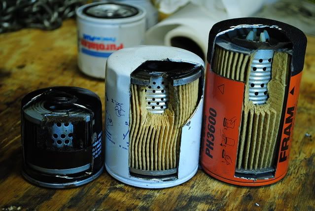

Oil filters:
I've cut some apart to see how there designed inside.
A Mazda, Purolator, and a Fram filters. (The Fram is off some other car but the other two are off a rotary.)

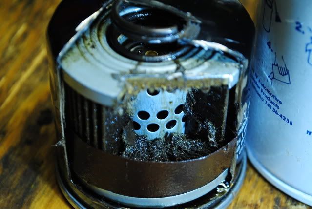

Mazda. (Soaked with oil.)
Purolator.

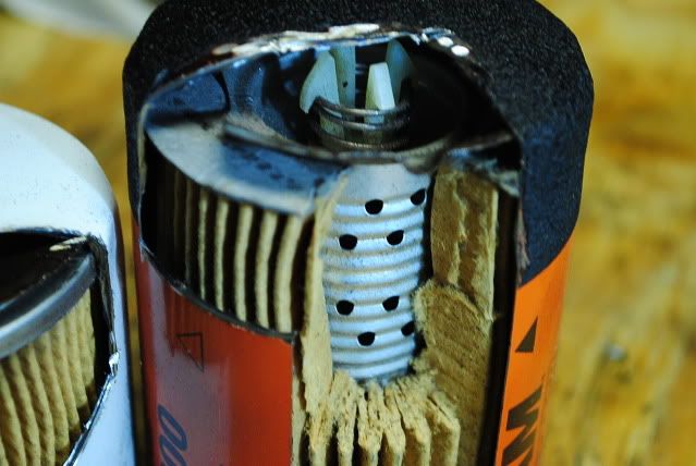

Fram.
IMO, I like the way Mazda and Purolator are designed, but Purolator is cheaper ($).
Anyone have any more/other info on filters? Feel free to share.

This is what ive seen, fram shouldn't be in this at all, it doesnt have a check valve in it so the way they mount on a rotary once the oil stops flowing all that dirt and particles the filter has caught now leak back into the motor. Fram for a rotary sucks
purolator or mazda would be the only filters id run both are very good, im sure the purolator is a little better then a oem filter but i wouldn't swear to it.

While I will agree that Fram has a poor reputation and I avoid them, your scenario is not accurate. The check valve only ensures that oil is held in the filter to avoid dry starts. The "dirt and particles" that might be entering the engine from the cooler come in through the bottom of the rear iron, up the iron to the middle of the filter, through the media, out of the filter, and down to the rear main. The only way for the bad stuff to get to critical parts of the engine is through the filter media (whether the engine is running or not). There is no possible way for it to "leak back into the motor".

Interesting. How many miles on the Mazda and Puralotor? Were they taken off same motor?

that doesnt look like a purolator for a mazda but i could be wrong,

The cut-up Purolator filter actually might be off some other car as well.
I cut-up the Purolator and Fram filters years ago.
Btw: I never liked Fram.
