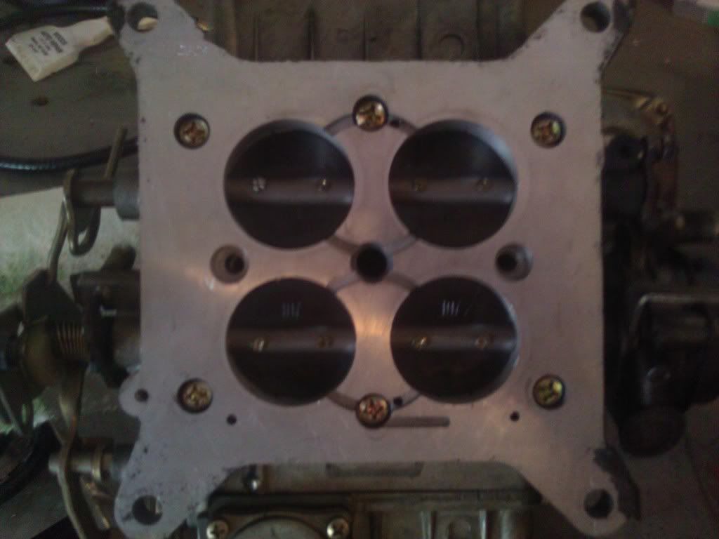

damn jeff you see my new issue

I don't know what blocking those little channels would do. I don't know enough about holleys to know what to suggest. Maybe ask on the forum?
