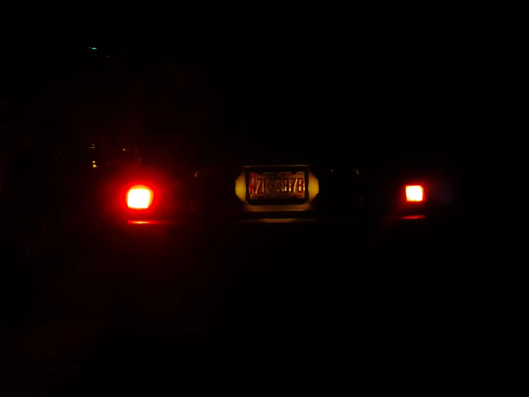

Heres the pics of the side markers, the first is OEM and the second is LED. Excuse
the photo quality as I was just using my phone, but I think you get the point.
These are the photos of LEDs in the drivers side rears only. Backup light is
amazingly bright.
Lights on:
Backup lights on:
And brake lights on:
