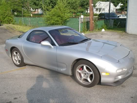

Sellers picture from two years ago:

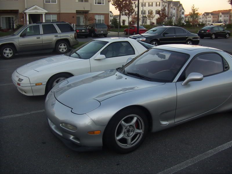

Next to my old second gen (sold)

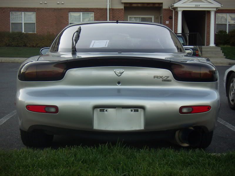

From the back
