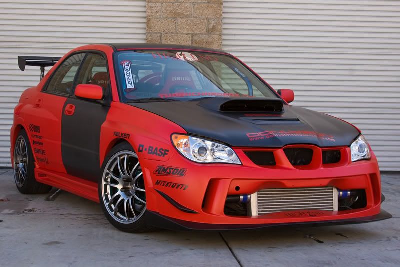

![]() Fwiw, I think the ricer in me is coming out, I want my car Satin red like this car. With some satin black accents in different spots. ![]() |
