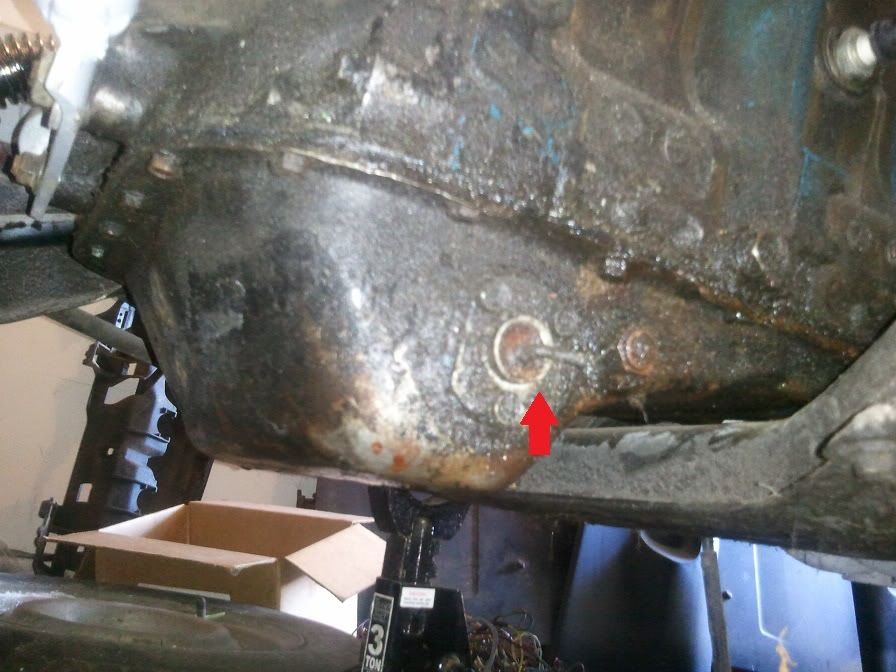

Sadly I don't know what year 12A it is. The 2nd picture is of a tube protruding from the oil pan. I'll take a better picture.

Here's what the 2nd picture was of.
Is this an oil temperature port or ??

Old 09-24-2011, 06:27 PM   #6
Originally Posted by dr.occa View Post
Good to know
Much appreciated.
That wire is what he's talking about here.
Originally Posted by N.RotaryTech View Post
The wire coming from the oil pan is from the level sensor.
Find a white connector in the engine bay near that area, its a 2 pin connector. (note, I know this is on FC's, not sure if it is the same connector on FB's)
Repair the wire, hook to said connector. When low on oil an annoying buzzer should go off.

yep, just cap the one on the iron and vent the one on the filler neck with a vacuum hose to either: bottom of engine bay, oil catch can, back to intake. What ever you prefer.
Also.
The bolt looking thing next to the level sensor is a factory temp sensor I think. An aftermarket temp sensor can bolt right in here.
