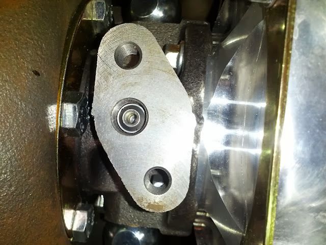

Has anyone else encountered this? My turbo oil feed port is off center, and doesn't line up well with the fitting.
