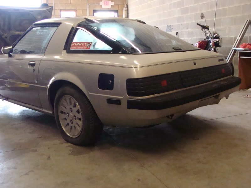

Here is the epic tale of my build thread for a 1982 GS i picked up locally.
For starters, the car is clean. Almost too clean in some ways and i love the earlier interiors.
Here is how i got the car:

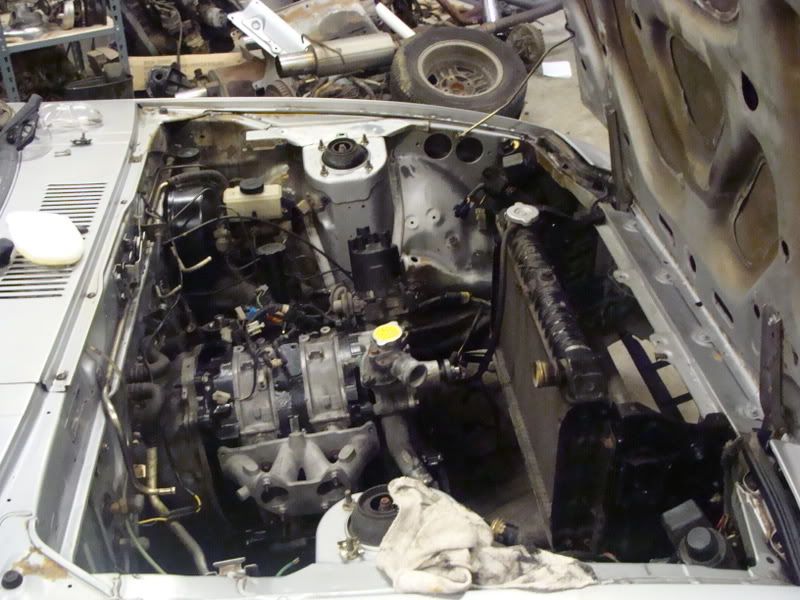

Next i pulled the motor out. The engine is a good 12a engine, i just want to go over EVERYTHING i can. Plus removing the rust proofing gunk is easier this way. My fiancee, Amy, cleaned the engine bay for me. Carb cleaner and

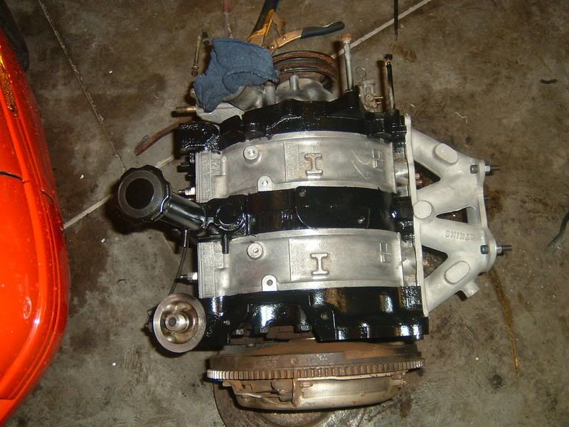

with the motor pulled i started to degrease and scrub it clean. Once that fiasco was done, i pained the irons with ceramic spray paint for some visual appeal.
I also swapped out the GSL-SE front struts i had. Already have Eibach springs and some Adjust. illumnias.
I also am using a stock replacement clutch and pressure plate. The 1982 has the "light weight" flywheel, so the pressure plate is different than other years. Napa "zoom (valeo)" clutch only set me back about 130 dollars and came with the everything, including the alignment tool and throwout bearing and grease.
For the intake manifold, i splurged and got the Atkins rotary side draft manifold. Its a nice piece, but the ports need some reworking.

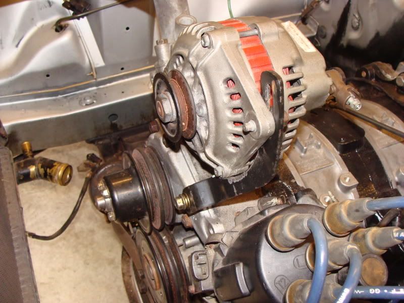

Also you can note in the picture that i am using an FC aluminum pump housing with a FB aluminum pump. Everything works out fine less the alternator mounting point. As you can see, air pump brackets and little grinding and solve this.

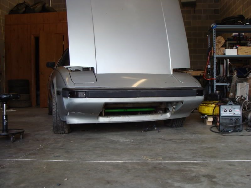

It is certainly colorful under the rear, with the orange trailing arms & watts link, and the bright green ST swaybar. I dunno what inspired ST to switch to that color on their springs and sways.....
Rogue_Wulff is offline   Reply With Quote
Old 07-14-2008, 02:46 PM   #11
they actually gave me an insert page talking about the color choice.
