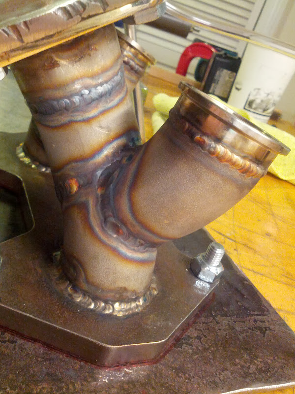

Small update:
Made the cut outs for the wastegates. Used a plasma cutter, then cleaned up with a carbide.
Set up dual flow meter/regulators so I could backpurge the manifold during final welding.
Did the finish welding on the wastegate flanges.
While welding the second flange the foot pedal control for my TIG crapped out. I had to finish it with the 2T torch control I hate using the torch control. Had planned to finish all the welding today, but will have to wait until the new foot pedal comes in.

Teee Heee! That setup seems to be perfect on the bottle awesome..
Love it looking great!

Got my clutch. Exedy twin disk. My buddy Tyler gave me a unbeatable deal on it. Thanks brotha!
Also finished up the turbo manifold.
Will have more pics once it's cool.
