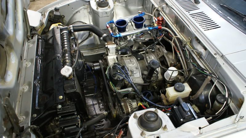

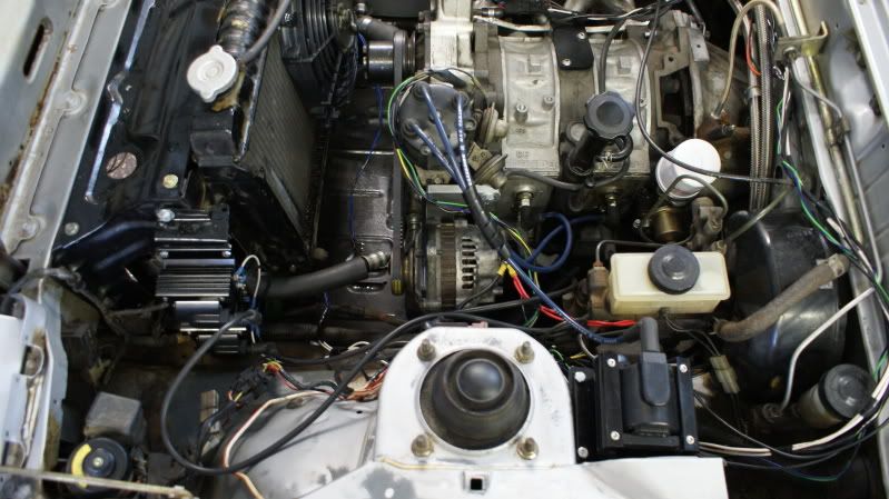

Got a lot accomplished today and yesterday. Saturday i drilled the manifold for the vacuum references and the GM IAT. Also started some of the wiring needs.
Today was very worthwhile. Finished a ton of wiring for the gauges, the megasquirt, engine bay related, switches, etc. Also install the injectors, the Atkins EFI EGR block off kit, the RB header i picked up. Etc. Most of the wiring harness has been sorted. Only a little bit more to go.

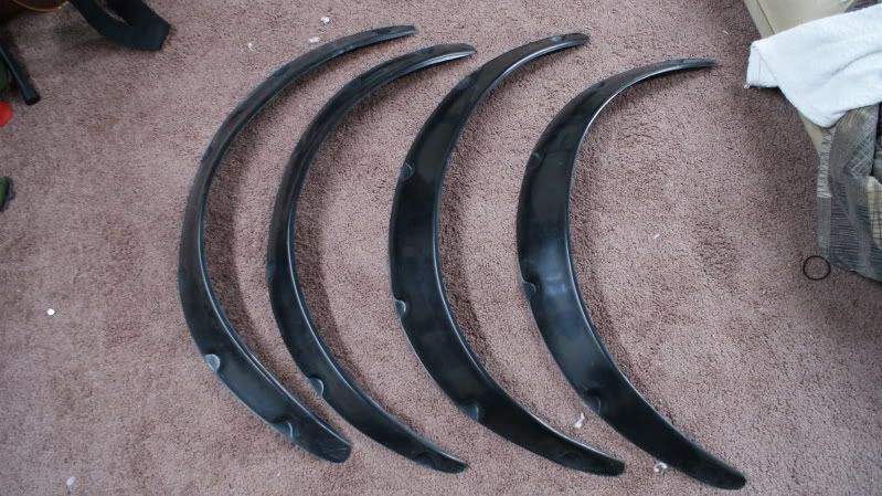

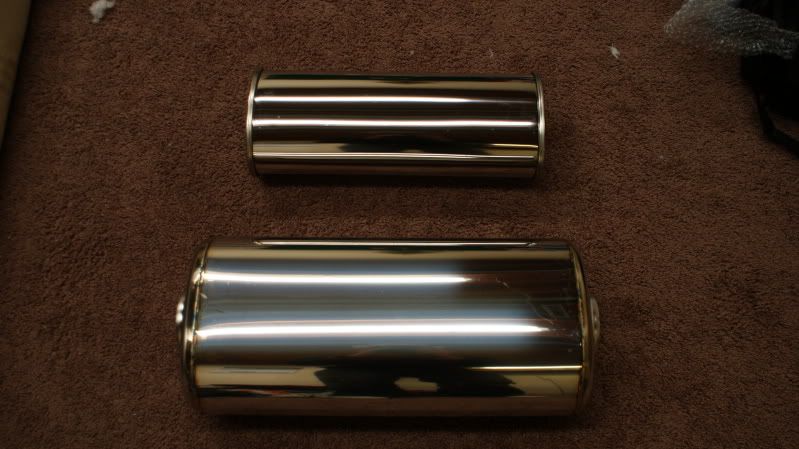

Classicdatsun.com fender flares and racing beat muffler and pre silencer came!

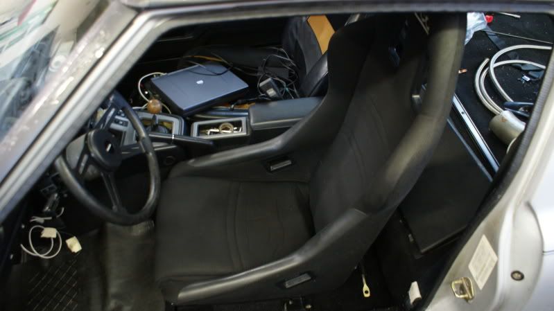

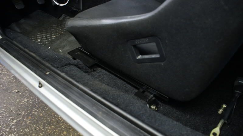

Well i got a fair amount done. Wheels and tires are now on the car. Battery is installed, the Sparco seat is completely installed. Fuel pressure gauge (mechanical) is almost done. Need a 90 degree 1/8 NPT. Im hoping to charge the fuel system tomorrow for the first time for leaking. Then also get some more wiring done. If i can i want to start the "starting" process Saturday.

As for the progress. Well it starts and holds an idle more or less. First start was open header. (dang) Started up very easily though. Still wants to stall on occasion but i have had no chance to tune anything as of yet. I reflashed the MS2 to use the MS2 extra firmware. Which has some pretty good controls.
Also had to replace the alternator. The S5 i had gotten wasn't charging. Took it to autozone, tested bad. Had a spare s4 one laying around so i adapted that. Issues resolved.

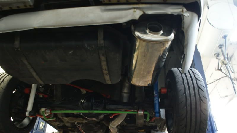

With the day coming to a close, i decided to tackle the final big step. The exhaust. A friend of mine lent a huge hand and didnt the welding since i haven't for almost a year now and we didn't have time for me to get back into it. Generally went well. Used the Racing Beat 3" universal muffler and pre silencer. Still need to decided on a tip for the muffler.

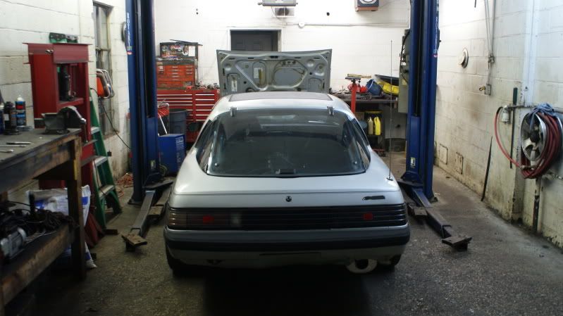

As far as media with the car running, well tomorrow or the next day i will have a video of it running any maybe even driving. we shall see. There are plenty of issues i need to address including the fact i *can't* get the car in reverse. The clutch also engages pretty low.
