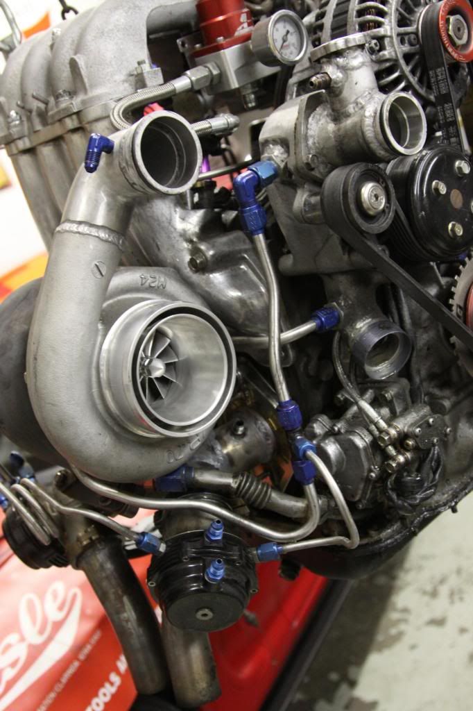

Small update.
Got started on doing hardlines for wastegate coolant. Will also be doing turbo coolant/oil in hardlines as well.

It looks like you are flattening out the tubing when making the bends. What bender and stainless are you using, also what wall thickness?
Thanks for the compliments on my build. I plan to replace the stock hardlines with -8 lines this winter under the car.
The supply line to the front wastegate was the first one I did. I think the first 90° bend off the wastegate flattened out a bit. I don't think it's enough to worry about, but good eye. I'm getting better as I go
I'm using the mastercool bender, and 1/4" .020 wall 316L stainless tubing.

That seems like the only one that flattened out. You can cheat and put it in the vise and squeeze it back into shape. It is best if you have plastic or aluminum jaws so you do not mar the stainless. Sometimes that works.
Nice work on the lines. It takes so much time but is worth it at the end.
Are you going to make a hardline turbo oil drain as well?
That's not a bad idea. I have the aluminum AN jaws that might work. I may give that a shot thanks
Thanks, yea it does but I totally agree when it's done it looks so good. Maybe it reminds me of my childhood playing with these but who knows
Yea I plan to do all the turbo lines in hardlines as well. I need to find a bender that can handle the -10 though.

That hardline setup is sweet, what kind of fittings are you using and how does it seal up at each one, single or double flare?
Thanks. They're AN tube nuts and sleeves. Single 37° flare.

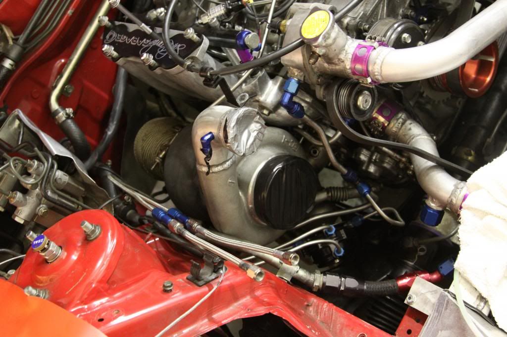

I have aluminum banjo fittings on my turbo, the anodizing is heat faded but they did not melt. I too have a good thermal siphon. I think that is something that is commonly overlooked when installing a turbo. The steel is a helluva lot cheaper though.
I could not find a -10 bender that would do a tight radius and allow me to make a hardline turbo drain that way. I ended up purchasing a -10 adapter to bolt to the bottom on the turbo then bought a -10 fitting with the pipe coming out of it and welded the flex joint from the stock turbo drain to it and modified a few other things as well. It was a PITA, especially with the engine in the car. I may remake it so it is a bit cleaner than what I have.
I am interested to see what you come up with.
Here is a pic to show what I am talking about. Hope you don't mind me posting it here...

I have aluminum banjo fittings right now, it's the only thing I could use since I have very little clearance on the turbo to LIM and turbo to strut tower. I haven't had any issues with anything melting. The EFR has two coolant ports on each side, and they tell you to hook the feed line on the lower port on one side and the return line on the top port of the opposite side, I assume that's what you're talking about with thermal siphoning.
That's a cool setup also. Are you going to use hard lines for the vacuum lines too? Right now I'm using nylon braided lines with AN fittings for my vacuum lines on the WGs, also wrapped in heat barrier.

^, yes, I use stainless hardline on the wastegates vacuum lines. I just do not have them pictured. This pic was taken after I blew my motor this year. I had 5k miles on the turbo setup and lines at the time. 70k mi on the stock motor.

^ This is the best I could find. I wanna redo it and make the lines shorter and use some different fitting to route the lines better and relocate the solenoid. Since I have the engine out this year I will get some pics but hopefully you will have yours done by then. Yes it is a 4 port.
this is a better pic showing the drain. I think it looks a bit crude and will probably try to make something a bit better and more professional looking.
